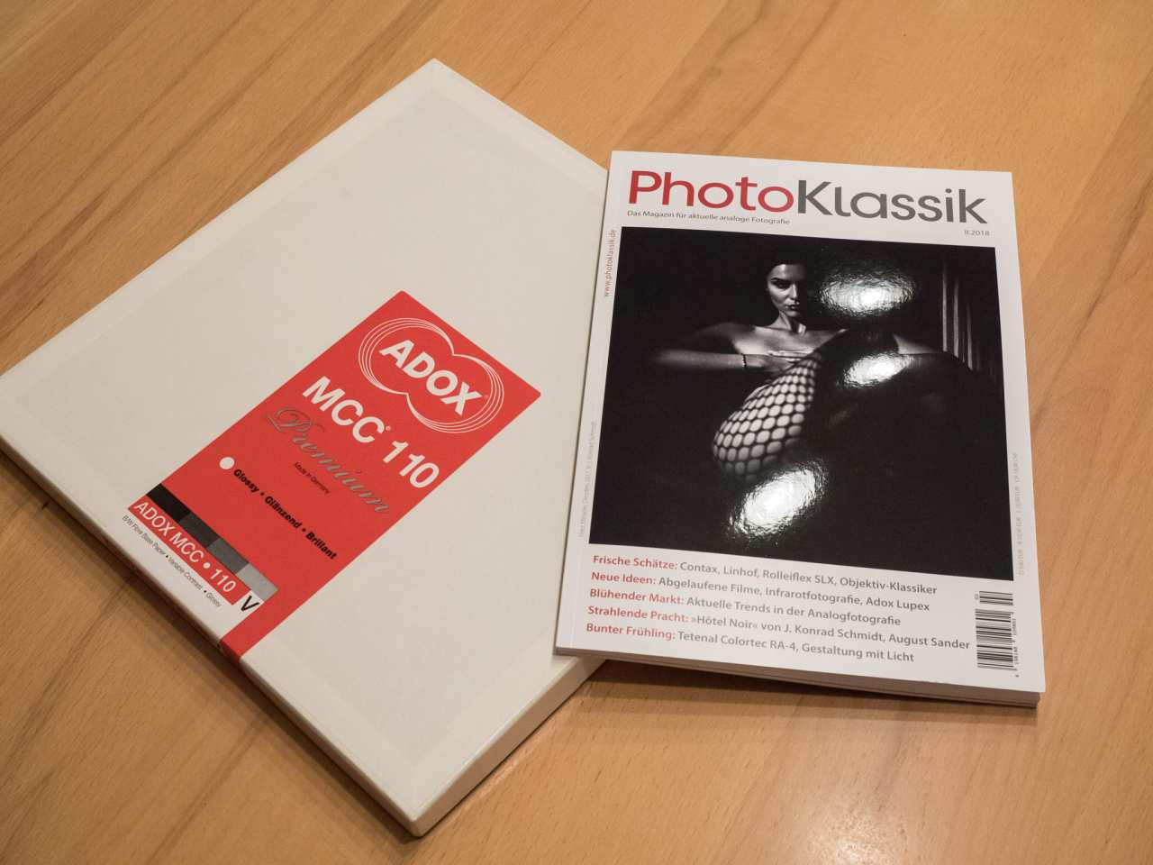

Adox MCC fibre base paper and MCP resin coated papers are available in A4. Someone mentioned that Ilford has A4 as well. The Adox MCC ist additionally available in 20x30, close to A4 and in theory perfect for 35mm negatives. MCC ist also available in 30x30 and 40x40 for square negatives. I just bought a box of 30x30 and looking forward to using it.

lantau
Jan 15, 2016
826
Germany
Thanks, I didn't know that! And then there are those particularly peculiar square people too! They have a hard time printing on any available paper....
There is nothing peculiar about printing a square negative onto square paper!
I didn't take one of the box alone, but it is square. 30cm x 30cm.

NedL
Aug 23, 2012
3,404
Sonoma County, California
That's excellent, I didn't know it existed. I haven't tried MCC 110 myself but have heard nothing but good about it.
