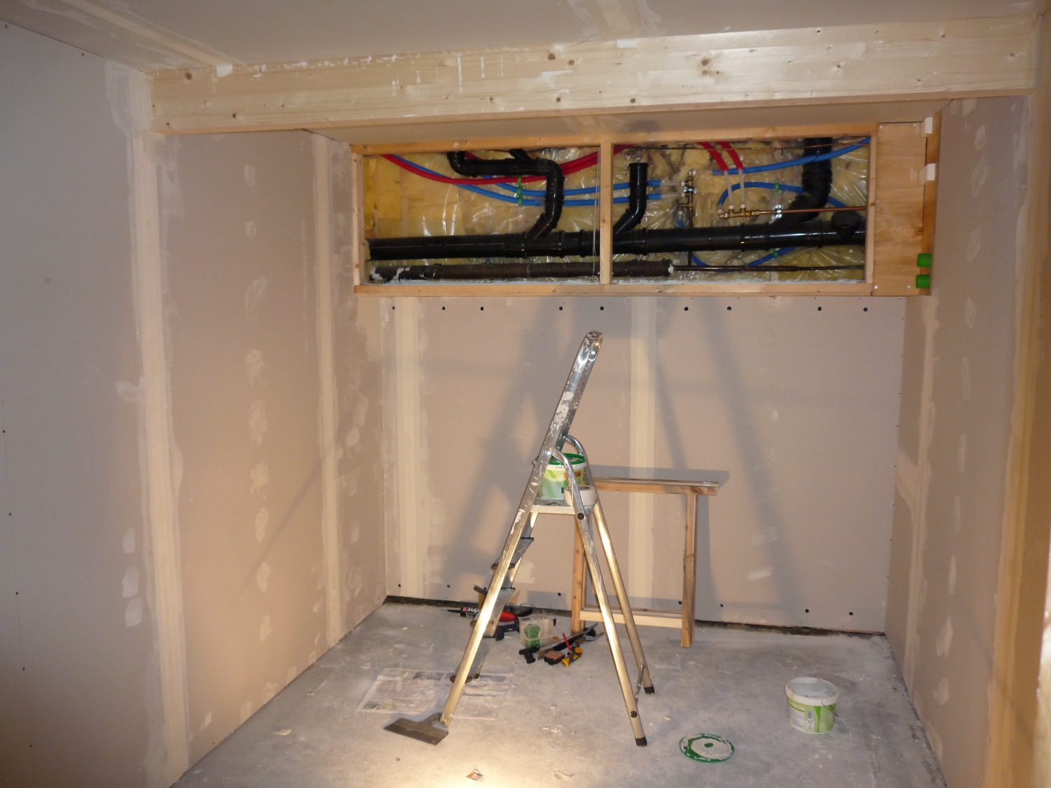

I have just built a print drying rack for my new darkroom. The idea comes from the excellent book "Build you own home darkroom".
The rack is on wheels so that I easily can move it in and out of the darkroom, and has been designed to accept 10 50 x 60 cm prints. It's just 1 cm narrower than the door into the darkroom.
Now it needs a couple of coats of varnish, and I have to make the screens.
