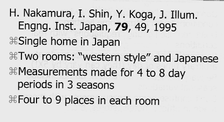

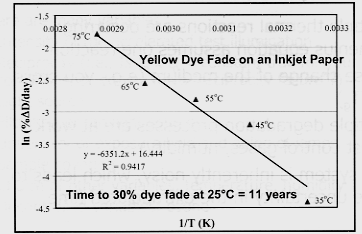

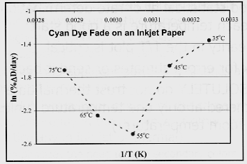

Let's start with Arrhenius. His equation states:
Arrhenius' equation gives the dependence of the rate constant of a chemical reaction on the absolute temperature, a pre-exponential factor and other constants of the reaction.
a9278432022fedbd50a4d635b05b546d734ad9ba
Where
But, he only considers one thing, as causing an influence and that the material behaves!
This is a good example and is a yellow azo dye in a gelatin matrix.
And this is a bad example. It too is an azo dye in a gelatin matrix.
And this is a test of 2 dye coupling products which show 100 years good keeping, but --- wait for it ---- only if Ozone is excluded. If Ozone is present, then stability falls markedly and product "B" becomes a bit better than "A".

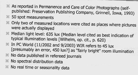

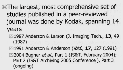

Where does this sort of data come from?
Kodak and Fuji offer the most comprehensive - and peer reviewed studies.
WIR offers self published data with no peer review. As noted, spectral distribution is not included, nor is any seasonal data which is included in the Kodak and Fuji publications.
Now, all I can offer on Azo dyes is the fade of some inkjet materials as it seems that, as I said before, Ciba/Ifochrome is a dead product and has not been studied for years. However, I can comment on my previous post citing some yellowing. When Azo dyes are split the -N=N- bond becomes 2 -NH2 bonds on 2 molecules and these can decompose and form yellow materials if not washed out properly. In addition, poor washing can lead to this problem and so faults in the process (mine apparently in this case) can cause problems even with extreme care. It seems that these dye bleach products are very sensitive to yellowing just as old chromogenic prints were.
How is this for a start?

Wilhelm offered data with no peer review. Take that as you may. Fuji and Kodak subjected their data to peer review. This is significant if you understand the "science" of publication of technical data.

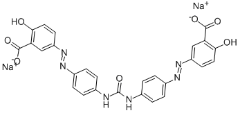

Now, back to fade... Note the reciprocity above. At different temperatures, fade of dyes is vastly different. These, under other circumstances, are quite similar to those used in printer inks and Ilfochrome, they are azo dyes.
This is an azo dye. During bleaching, all of the N=N bonds are clipped, in this case, 2, and the remains must be washed out. If not, they yellow. Calcium in the water can replace the Na ion and cause a precipitate and eventual yellowing of the residue.

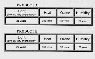

EK uses natural tests in homes all over the world. In addition, they use SANS (Simulated Artificial Nortlight) and a High Intensity fade station. All of these have the spectral distribution tracked at all times. Samples are compared periodically at intervals for fade.
More recently, tracking of and inclusion of Ozone and Sulfur Dioxide are part of the testing.
In addition, samples are heated to 140 F at 70% RH and 90 F 10% RH for wet and dry oven keeping
Dye loss of C/M/Y and neutrals are tracked quantitatively as is any increase in Dmin.
Both Kodak and Fuji watermark their paper on the back. Ilfochrome is on a plastic reflective material. Other manufacturers and many inkjet manufacturers do not watermark their paper.
These short times at high temperatures or intensity are not really indicative in many cases because the Arrhenius equation only considers one variable. See the above graph for reciprocity failure in fading of some inkjet azo dyes.
PE
