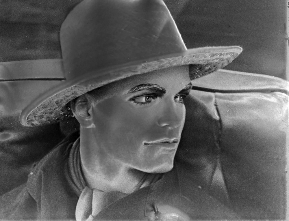

My photography students playing around with soaking photo paper in developer before exposing it to image forming light, then solarising with a brief flash of room light, followed by stop and fix. We've been getting some great results. We've also been doing same to our pinhole images.
Manny The Mannequin, was shot on HP5, developed in Ilfosol-3, 1+14. Ilford MG IV Pearl. MG developer 1+9.

How do you expose to image forming light after the developer soaking?
The enlarger was set up and image focused on a sheet of plate glass. Tape on corners to indicate where the image is. The photo paper is soaked in a tray of developer for a couple of minutes, drained, then placed on the plate glass under the enlarger. I taught my students to do their exposure incrementally...usually 3 sec increments. This way you can see the image emerge a little after each exposure. They are amazed at this! The exposure for Manny was 4 blasts, 3 seconds each. Any more exposure after that seemed to do nothing as the developer in the emulsion had exhausted itself. Making sure no one has photo paper out, the room lights are switched on and then off when there's the slightest graying of the whites. Then plunged into the stop, then fix.

The Emmermann process is basically exposing photographic paper that has been soaked with developer. I believe the original motivation was contrast control with the shadows partially developing while under the enlarger. This shadow density then self-masks while further exposure chases highlight density.
I've tried this in the darkroom with not much success but considerable wastage of time and materials. Resin coated photographic paper delivers wilder results than fibre base because the reserve of imbibed developer is less and edge effects due to local exhaustion are more prominent.
The inventor of the process could be Curt Emmermann, and I could be wrong too.
Internet searches for Emmermann process photography deliver few results for this obscure technique.

In honour of PE's memory, I'll just mention that this appears to be a version of the Sabbatier effect, and not solarization per se.

I used the technique several years ago to make a Sabbatier aka solarized print. I went through a number of 16x20 sheets before I got one I liked. On my college student income at the time, the cost was quite dear.
It's an interesting technique, but messy. Doing it on glass is a good idea, I just put the wet paper on an easel, which needed a lot of cleaning afterward.

Haha no worries, Matt! I'll stick with solarisation, because when we go hybrid with their pinhole negatives, I want to show them that that effect can also be done in PS, and that it originated in the darkroom... Like most of the filters and effects there.

Without flashing, it's trick to print very contrasty negatives by using self masking of partially developed print and your technique with 3 sec burst of exposure is the key for it.
That's a nice trick! I guess it might also be useful while making reversal prints from B&W slides.
