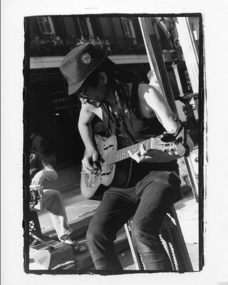

You're only limited to your imagination. People file the edges of metal carriers for a rough look like the image below. Some people purposefully use larger carriers than there negative to see the sprocket holes etc. It's really highly subject to personal preferences.

I agree... borders are subjective and personal. There is no "right answer".
That said, it is useful to remember that borders should support the image not distract one's attention from it.
In my view, Christopher's example shown in post #3 is a very effective use of a border. It adds a bit of grungy (as a good thing!) atmosphere to the subject without being overpowering.

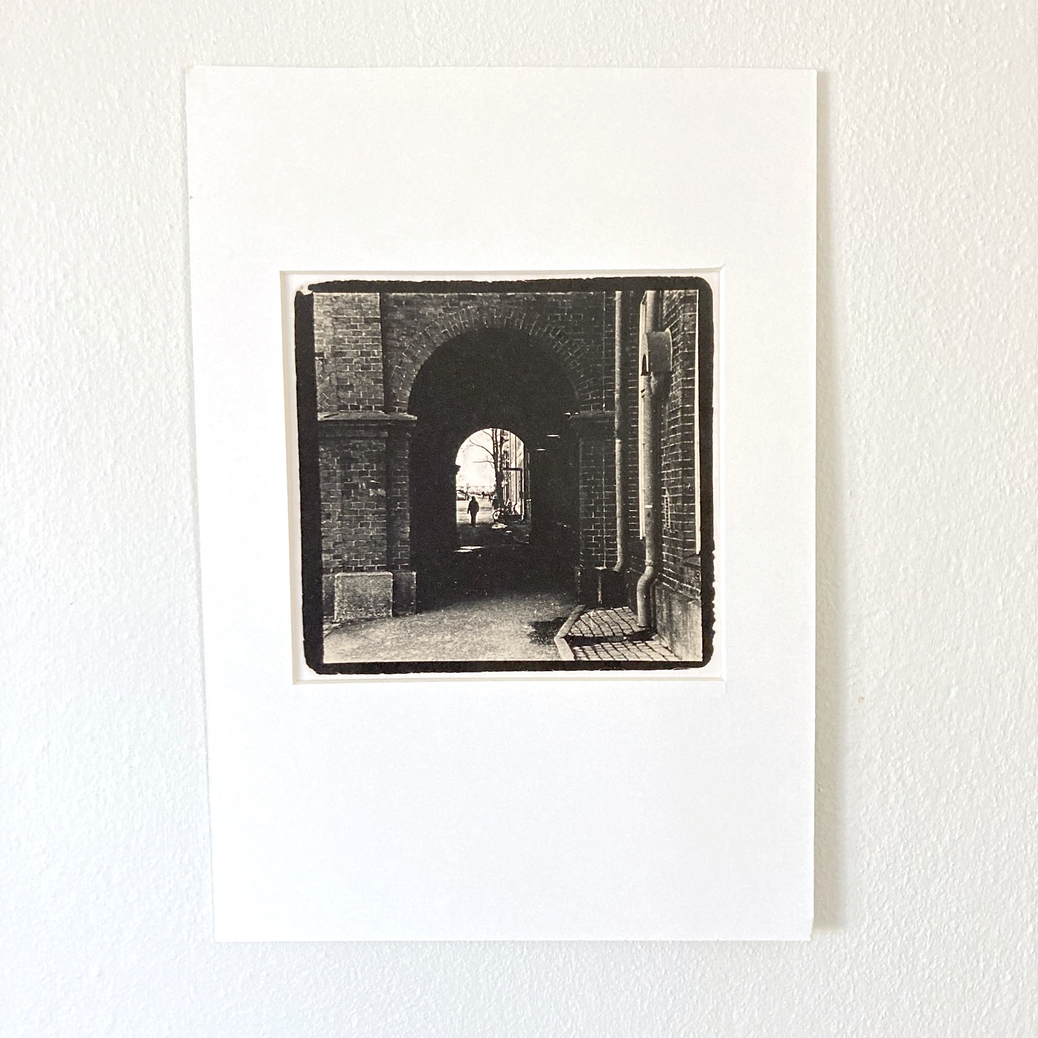

Here is one of my latest lith prints with "free" border. My negative holder is made from baltic birch plywood and that makes the edges organic.

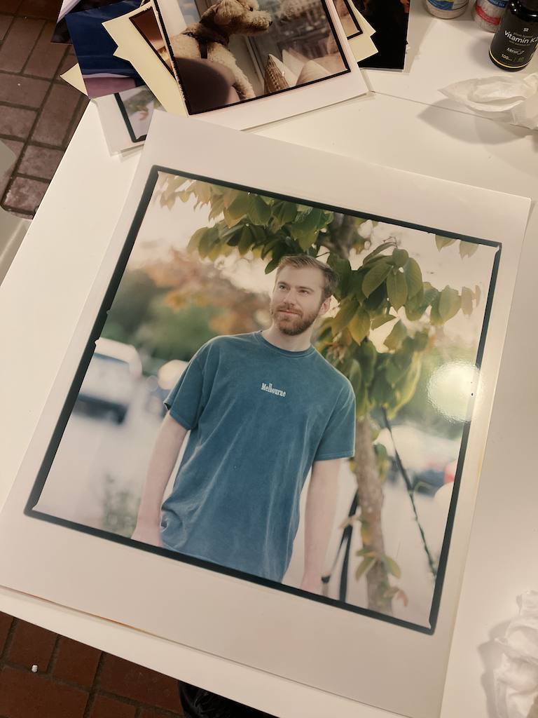

Using a diffusion light source with the standard 35mm negative carrier - not a filed out carrier - for my Omega D6 gave me this result:
I attribute the border effect to reflection/diffraction around the edges of the carrier.
