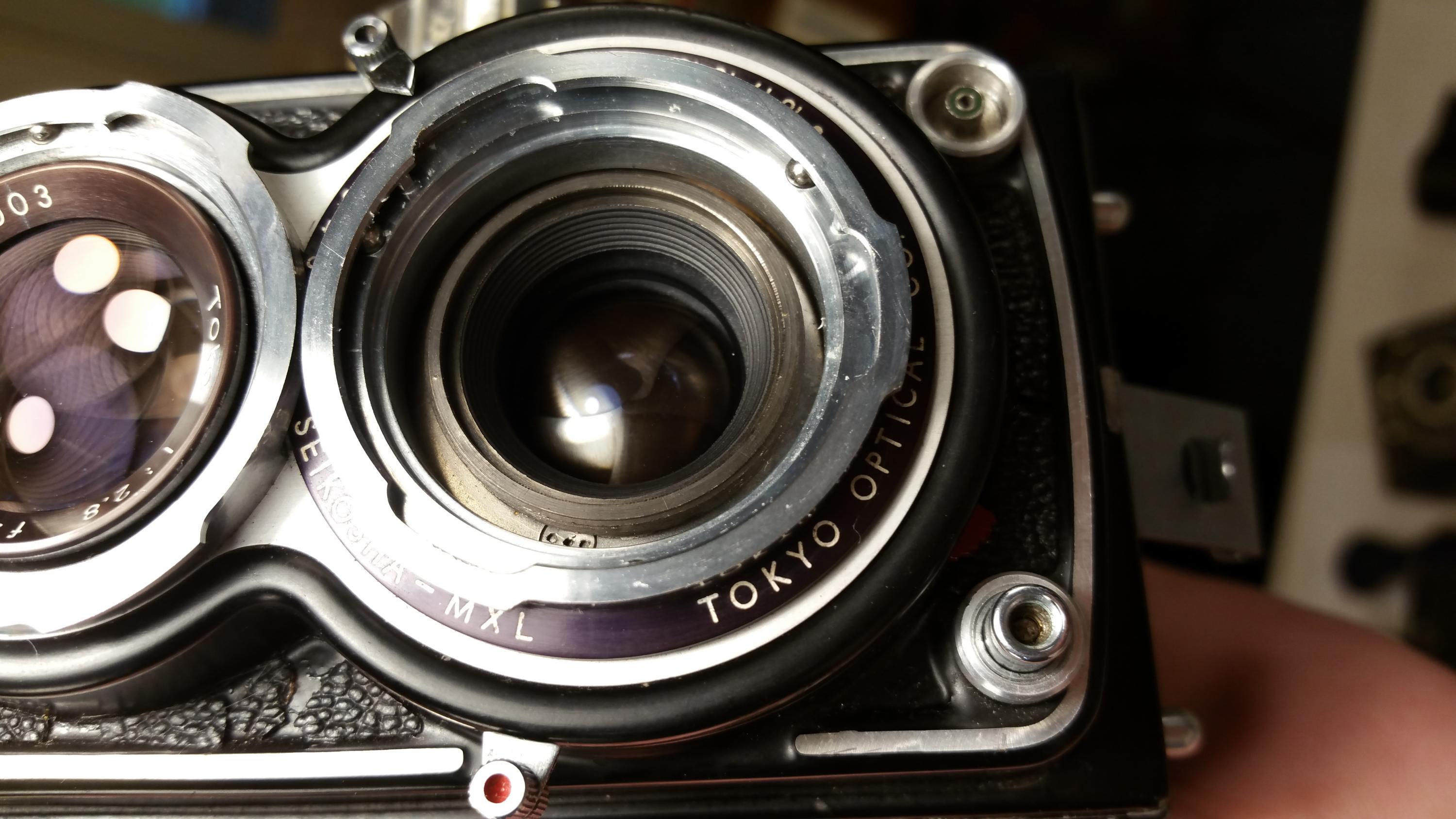

Were you ever able to find a solution to this problem?
I just bought a Primo Jr, same as yours. It has the same problem - the first shot will hang up - then work great. Let it sit for a few minutes, then it sticks just a bit. Ahhhhhh
I can see what looks like just a bit of oil on the edges of the shutter blades and I am sure this is what is causing this. I removed the front lens element, but can't seem to figure out how to get the next one out so that I can get to the shutter blades.
Can anyone help with this?
Thanks!

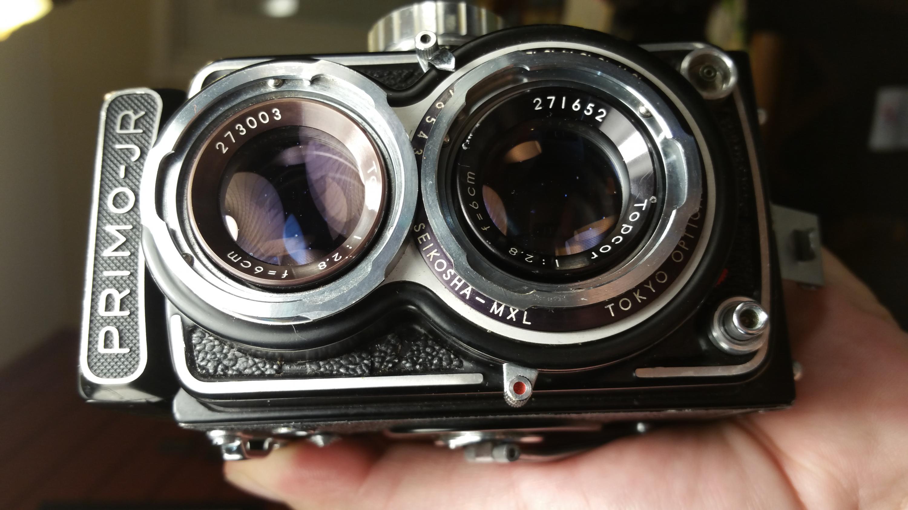

I think I answered my own question. The inner element is screwed into the shutter and it can be removed without taking the entire front apart.
After applying some Ronsonol to the shutter blades and letting it dry, the shutter seems to work like new.
Problem may be solved.
