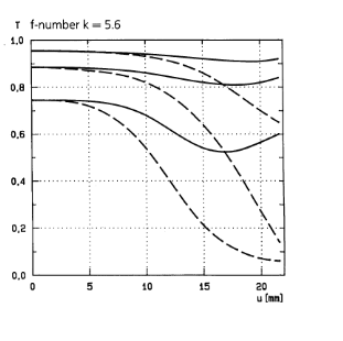

Use of conventional macro lenses such as Nikon/Leitz/Zeiss would make no sense because designed for much larger format (35mm ff).
This is the Makro Planar 60mm. Seems to make sense to me.
