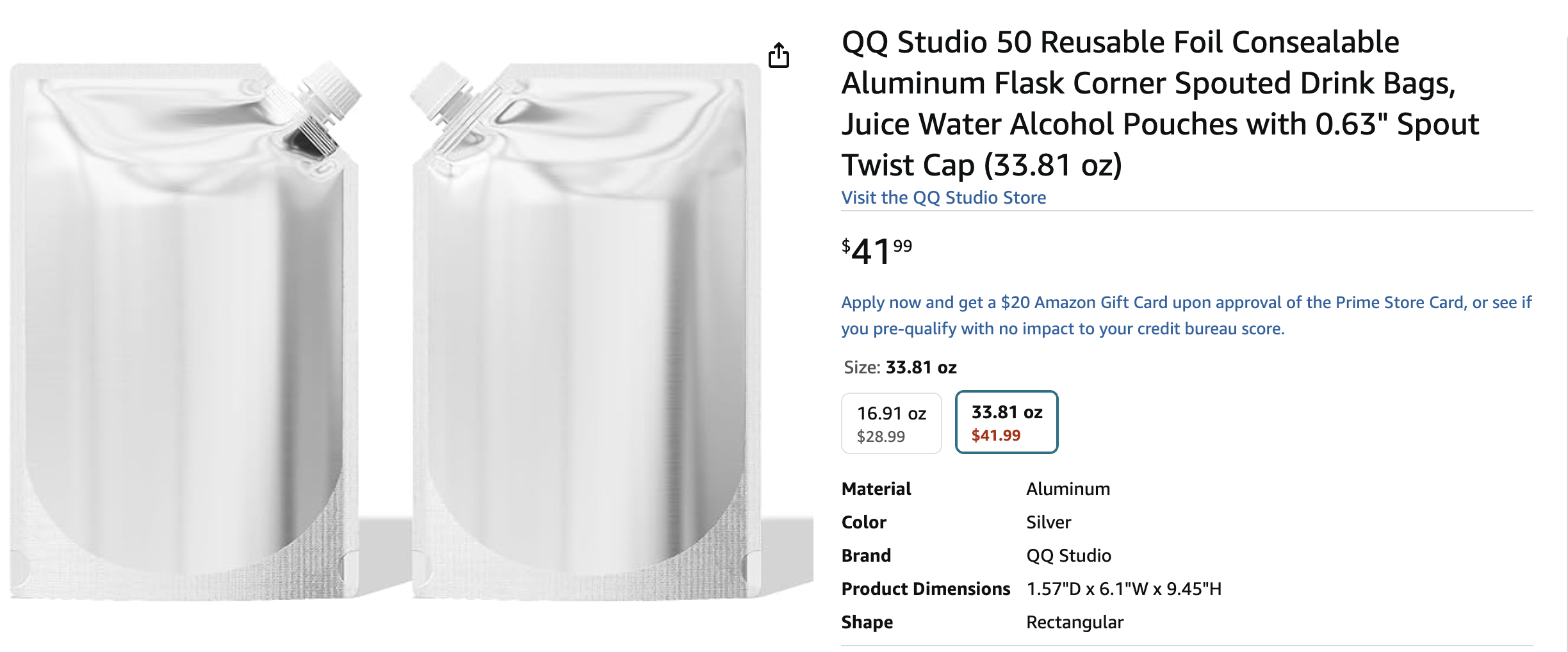

I use 500ml or 1L aluminum foil lined wine bags, and squeeze out all the air. This way, my C41/E6/ECN-2 working solution developers, fixers and bleach can last at least one year with intermittent use in between.

Hi blee1996,
What specific brand have you found works for you?
Thanks!

Hi blee1996,
Thanks!
The brands keep on changing on eBay and Amazon, and similar items appear and disappear. I looked up the most recent Amazon order of 50 1L bags just a few months back, and that item no longer exists. This is a similar one that is available now on Amazon.
Great! Thanks! I'll look into these!
Amazon will sell just about anything. These certainly aren't Aluminum, maybe Chinese Mylar knockoffs. Looks like designed for smuggling booze into a football game 😁☺️
