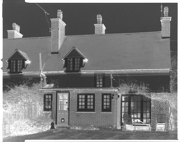

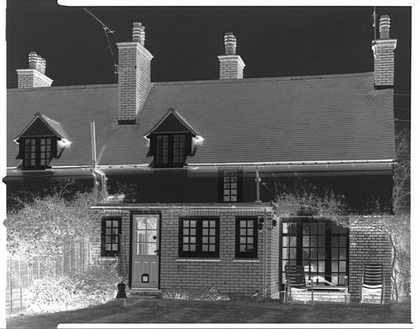

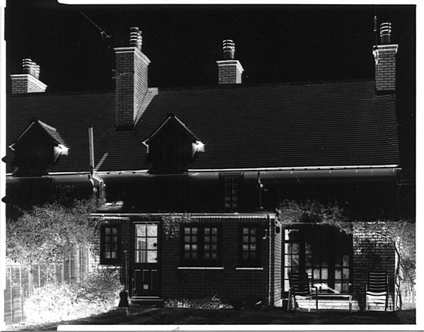

Photographic paper is not made for daylight exposures and reacts to the 'blue' light with high-contrast. The best way to make paper negatives (I'm a fan) is to use a yellow filter during the exposure and use half-strength paper developer. It will lengthen the exposure and processing time but does wonders to paper-negative shadow detail and make them a breeze to print. attached are some before and after negatives.

The idea with a paper negative is to fit all of the scene's brightness range onto the limited tones of the paper. So you don't want a paper negative to have the wide contrast range of a finished print; you want the tonal scale compressed, but maintaining detail in both shadows and highlights (ideally; sometimes this isn't possible, in which case you pick which is more important). Then, when you contact print (or scan and tweak in PS), you can extract the scene's full tonal range into the finished print.

Ralph, I'm intrigued by the yellow filter suggestion. Silly question maybe, but do you just hold the filter in front of the pinhole? The results look good.
Joe, thanks so much for responding. So you think I might also be underdeveloping? It's something I should experiment with, I suppose. I'll experiment with a "proper" light source for preflashing. I like your ideas.
For pinhole photography, it's held from underneath on the lens plate by a lump of blue-tack. But I also make paper-negatives with lens-based photography. I rate the filter/paper combo as ASA 3 for MG-IV paper. It gives me a beautiful tonality and easy-to-print negatives.
