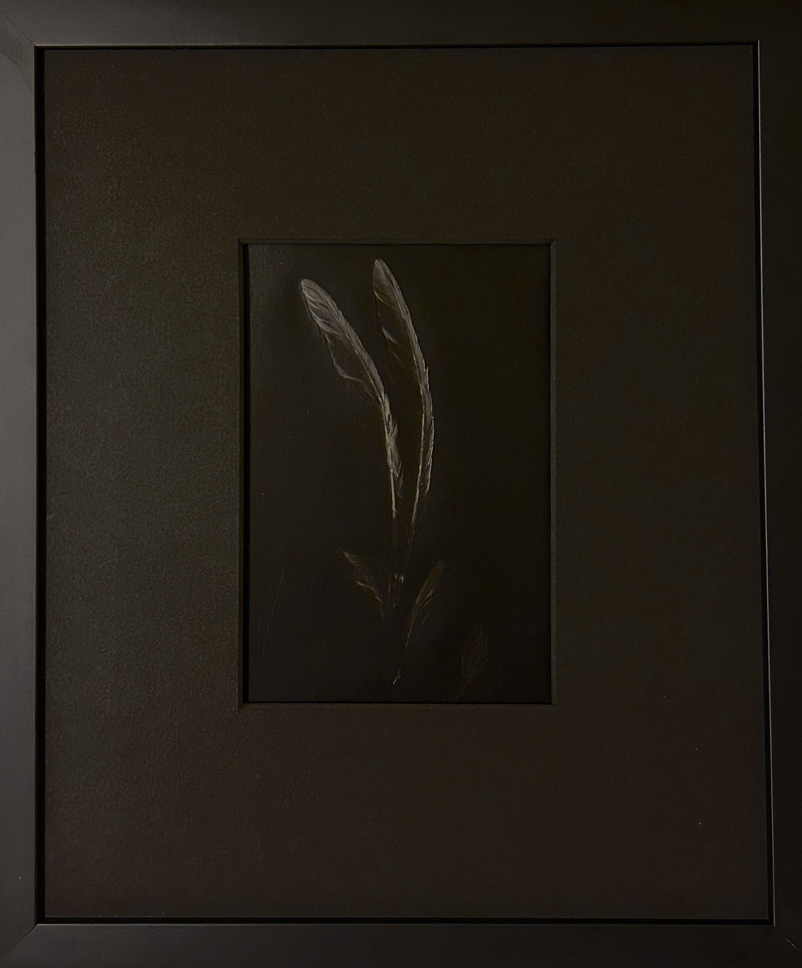

Sometimes black...
"Under a Raven Sky"
5x7 Photogram, Carbon Print
That’s a great treatment, Vaughn—I’ve seen some “plum” toned salt prints that looked great in dark mats as well. What size is the mat here for your 5x7?
Mat is 10x12. There is an 8 ply window-mat under the black mat to float it. No glass. The piece was put together for a juried Halloween multi-media show at one of our local art organizations.
Unfortunately the iPhone image shows much more of the feathers than can be seen with the eye...especially the lower feathers that are seen mostly as sunken relief.
Excellent, thank you kindly…that might be a print I’d take off the wall to examine more closely, though I’d probably get my knuckles rapped with a ruler. :wink:
