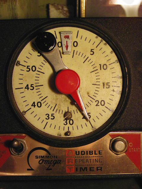

It is easy, but sorry cliveh, some of these are odd numbers... From 32 for example I count backwards by third stops... 7, 5, 4, 3 seconds.
I haven't memorized the sequence, I have to refresh my memory every time by looking at the black dots I drew on the timer...

As you can see, my third-stops are extremely low-tech black dots on the dial...
