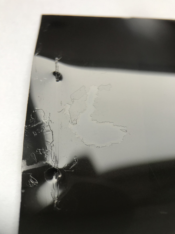

Last week developed 4 b&w films (∆100) in the reversal method.
I am using Ilford's workflow. And am working on optimizing the process. Which ISO, which developing time etc.
During the 2nd development bath I got a precipitation on the plastic parts of my development tank.
I am not satisfied with that. Something tells me that something in the process is not optimal when you get a deposit. In normal b&w development I have never had that.
Anyone have any idea where that precipitate from the 2nd development bath is coming from ?
Permanganate bleach in Ilford's process can sometimes peel bits of emulsion from the film and these bits could be the 'precipitate' you observed. Have you checked the film after the second development? Does it show any damage to the emulsion? Do you have a picture that shows the precipitate or the film after second development?

The emulsion adhesion is not optimal. At the place where I grabbed the film with my hand you can see damage.
See photo
In the light areas see that there are white spots.

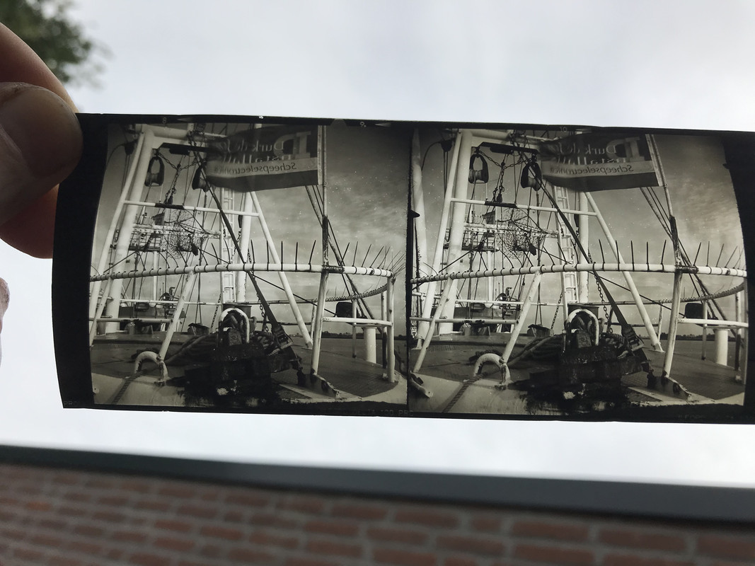

See photo
I used 0,2% Potassium permanganate solution which I acidified with 14 mL 37% sulfuric acid (which is a very small excess)
Possibly too long in the bleach bath? Should have done 5 minutes at 20 ºC. But I did 5 min at 24 ºC. It was warm in my lab and for the developer I adjusted the time to 24 ºC but not for the other chemistry steps.
Sadly, emulsion softening and subsequent peeling is a common problem with Permanganate bleach. Reducing the strength of the bleach can help in this regard - try 1% solution. Also, tight temperature control (20C) during the bleaching stage and the subsequent stages is advised. I use Dichromate bleach and it works perfectly. Copper Sulphate bleach also works fine.

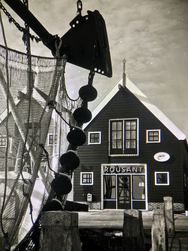

I happy with the density and contrast I found. Not with the white spots seen in the clouds. This stereo positive is made yesterday with a camera over 100 years old.
See photo

What was the final concentration of sulphuric acid? I’ve used 0.12% w/v potassium permanganate in 2% v/v sulphuric acid at 20-22C and worked fine for lots of 35mm films. Raghu is right about the temperature as that can increase emulsion damage.
I find it difficult to calculate in % for sulfuric acid . In chemistry, calculate in Mole is easier. I hope my conversion is correct
I make 550 mL of solution with 1.1 grams of potassium permanganate and 7 mL of 37% sulfuric acid.
I think that is equivalent 0.2% potassium permanganate in 0.32% sulfuric acid. This at 5 minutes at 24 ºC. Add the acid 5 min before I start and filtered just before start.
If I compare it to your percentages. So I have clearly more concentrated permanganate at lower acidity.
Next time I am going to bring the solutions to 20.0 degrees and choose the permanganate concentration lower. And then see if it gets better
You don’t have to convert them in moles since everything is done either by weight per volume (w/v) or volume per volume (v/v). The former is calculated by g/mL while the latter is mL/mL.
Since you used 7 mL of 37% sulphuric acid in a total volume of 550 mL, then your final sulphuric acid concentration is: 7 mL(37%) / 550 mL = 0.47%. I’ve read that the amount of permanganate is more of an factor than the amount of acid, although I have not tested this. But it makes sense because the permanganate just needs to be in an acid environment.
One thing you can do is to make a stock solution with 1.1 g of potassium permanganate (I assume you don’t have an laboratory analytical scale to get less than 1 g) in X mL amount of water, then take half of that for your final solution of 550 mL with the acid, so you get a 0.1% w/v potassium permanganate. Note that I would not store stock solutions of permanganate because it oxidizes into a solid black chunk of manganese oxide in days.
Also, are you using distilled water for the bleach?
No I don't use distilled water, but no problem to do it.
Preserved bleach bath of 1 day old tested today.
Put through the filter ('k-cup reusable replacement coffee filter')
Already seeing brownstone.
The bleach should be the only step where you need distilled water, this is to ensure there are no chloride that can cause solarisation. Check out Table 1 here: https://unblinkingeye.com/Articles/PBR/pbr.html
The white holes in your slides are definitely from emulsion damage, which Jens Oshbar talks more about in his protocol (check out section 9.5.2): http://www.ars-imago.com/productinfos/osbahr_reversal_films.pdf
He observed that prolonged bleach causes holes in the emulsion, which seems like what has happened to you.
The precipitates you saw are manganese oxides and permanganate bleach are one shot only. The best way for long term storage is to actually keep the potassium permanganate solids in its container and keep it away from heat and moisture. Use only when you need to do reversal experiments.
