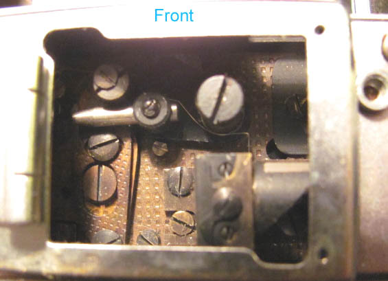

I got a pre-war Kodak Retina IIa (type 150) today, and the rangefinder needs both horizontal and vertical adjustment. I have never tried it with a pre-war model. I hope someone can give me advice before I remove the top plate, so I know what to do next (which screws to turn). This model has the viewfinder and rangefinder eyepieces combined, not as with the model before (type 142) with the separate rangefinder eyepiece.

I already have. I hesitated to email him though, since he's probably busy with answering emails and repairing cameras. :wink:
Here's the answer I got:
"Now, to make the horizontal adjustment, you need to use the red screw, of course the black one immediately above it in the photo must be lossened a little first.
The vertical adjustment is made with the two little screws marked with green dots. A tiny change here is all that is required usually, as you will find."
He seems to know everything about every Retina model. It's amazing. I will start working on the rangefinder as soon as it stops snowing, so there's something at "infinity" I can focus on. This is my second "150". My first has the 2,8 Xenon (five element Xenar. Very sharp lens) and this one has the 2,0 six element Xenon.
