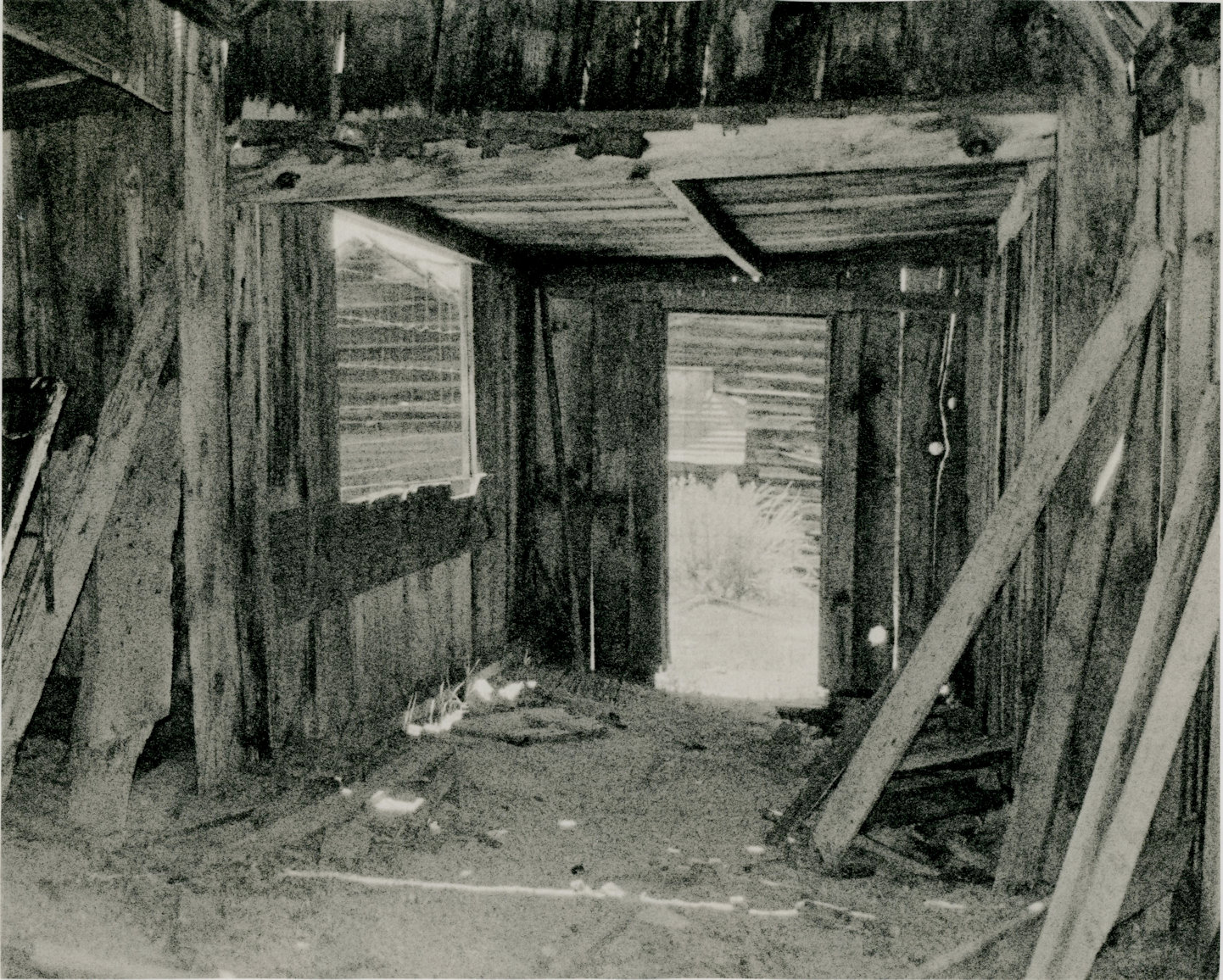

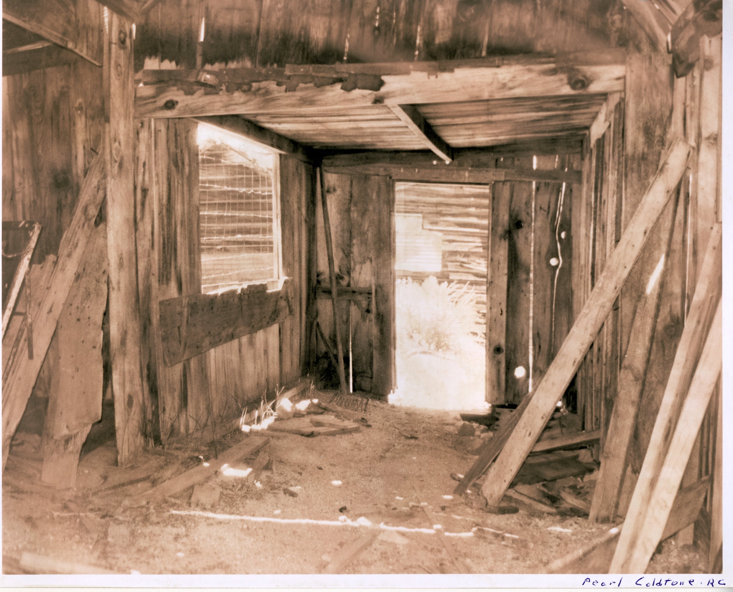

Greg,
I'm not a chemist nor a professional photographer .and not a very good typer- 1 finger.
The second was printed on Ilford FB glossy MC
1.presoak 2 1/2 minutes
2. developed for 15 minutes- arista powder a&b -5-5-20
3.wash 60 seconds
4.60 seconds in tf4 fixe
5.wash
first print on Ilford Pearl Coldtone RC
1. presoak 1 1/2 minutes
2. developed for 9 minutes- diluted same as above
3. wash 30 second
4.30 seconds in tf4 fixer
5.wash
These scans are close to what the print appears.Not to good at scanning.
I played around with the scanner setting for awhile, this is the best I can do.
