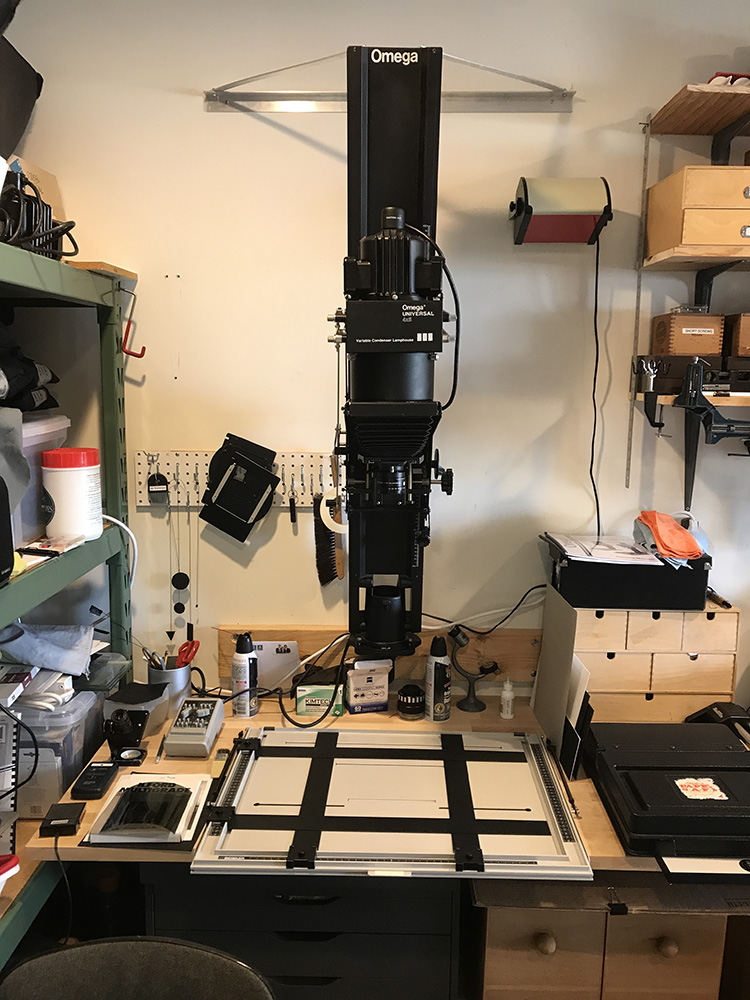

I've been printing on a Beseler 23c, but have long wanted to upgrade to a 4x5 enlarger. Unfortunately, they don't seem to come available very often in my market, but I currently have the opportunity to buy an Omega D5 enlarger with the DV condenser lamphouse. Before I go check it out, I want to make sure I do my homework. I did search, but didn't find much on these specifics:
1) What parts to I need to look out for to make sure it is complete? I'm thinking things like condensers, filter drawers, random mounting rings and other removables that go missing. This is a bellows focus model so it doesn't need cones, at least.
2) How is the D5 for printing smaller negatives, 35mm and 645? I know some of the Beseler 4x5 models have a reputation for being less than accommodating of 35mm.
3) How are these for stability of focus and evenness of illumination? My 23c's focus drifts such that I need to check every print, and its illumination tends to fall off badly no matter how I position the condensers.
4) Does the D5 have any "bad habits" that my Beseler is free from, that I might be inadvertently bringing into my workflow?
Thanks much!

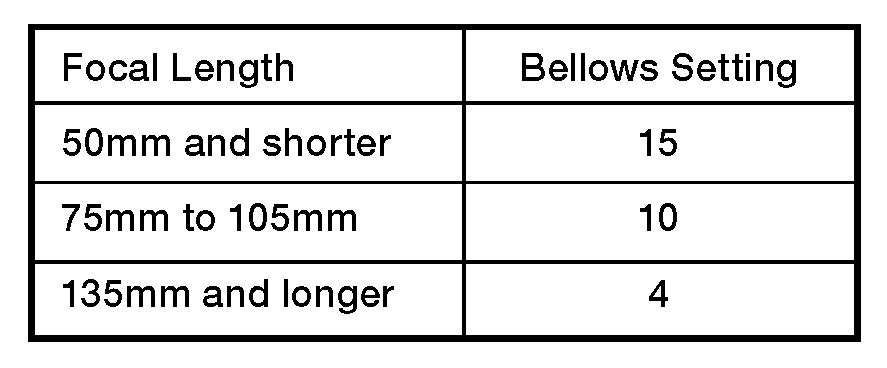

There are 3 condensers, on moveable and 2 fixed on either side of the aluminum cylinder above the negative stage. There is no filter drawer per se, filters go where the moveable condenser fits, either able or below depending on the condenser's position. Remember to adjust the lens bellows to match the focal length. I have had no problems with my D5XL, but I do recommend wall-mounting if possible and bracing the top to the wall as well. There are kits available but can be difficult to find. It is easy to make your own top brace.
