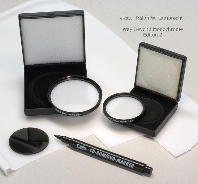

Well, before you ask, there is no reason to use film pre-exposure in combination with variable-contrast papers, but when using fixed-grade papers, it's a valuable technique to add shadow detail to the negative.
I use a self-made diffusion filter to make a Zone II or III pre-exposure.
