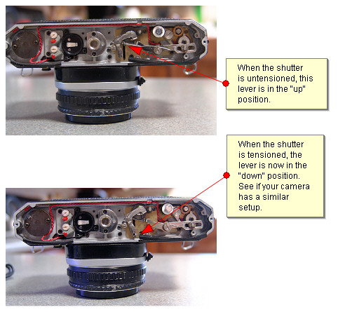

I just had a Pentax K1000 with a similar problem. I corrected it in about five minutes by removing the bottom plate and moving a lever into position so that the shutter button would release the shutter.
If you like, I can send you a photo of the Pentax K1000, and see if the Praktica is similar.

Here's what a Pentax K1000 looks like. See if your camera is similar. By pushing down the lever that I marked, I was able to release the shutter. I left the lens on the camera, so that you could tell which side was up and which side was down.

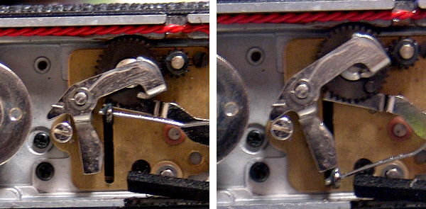

An addition to Mike's photographs:
As I said, I unblocked several cameras through he bottom plate and in most cases they looked very different from the K1000 illustrated....
Once the bottom plate is off, try to press the shutter release and see what moves on the camera bottom.
Typically, the shutter release pushes something down , which releases something else (which allows the shutter to fire). It is this "something else" which is sometimes jammed or out of place.
Might take a little careful probing and detective work, but if you are gentle and note where everything is (take a picture if possible) , you shouldn't do any damage.
Just fixed a friends K1000 with the help of this photo, thanks elekm!
