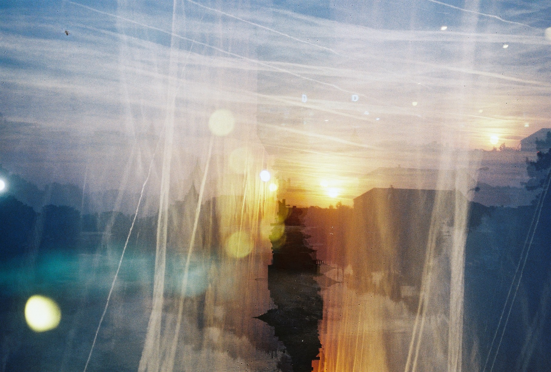

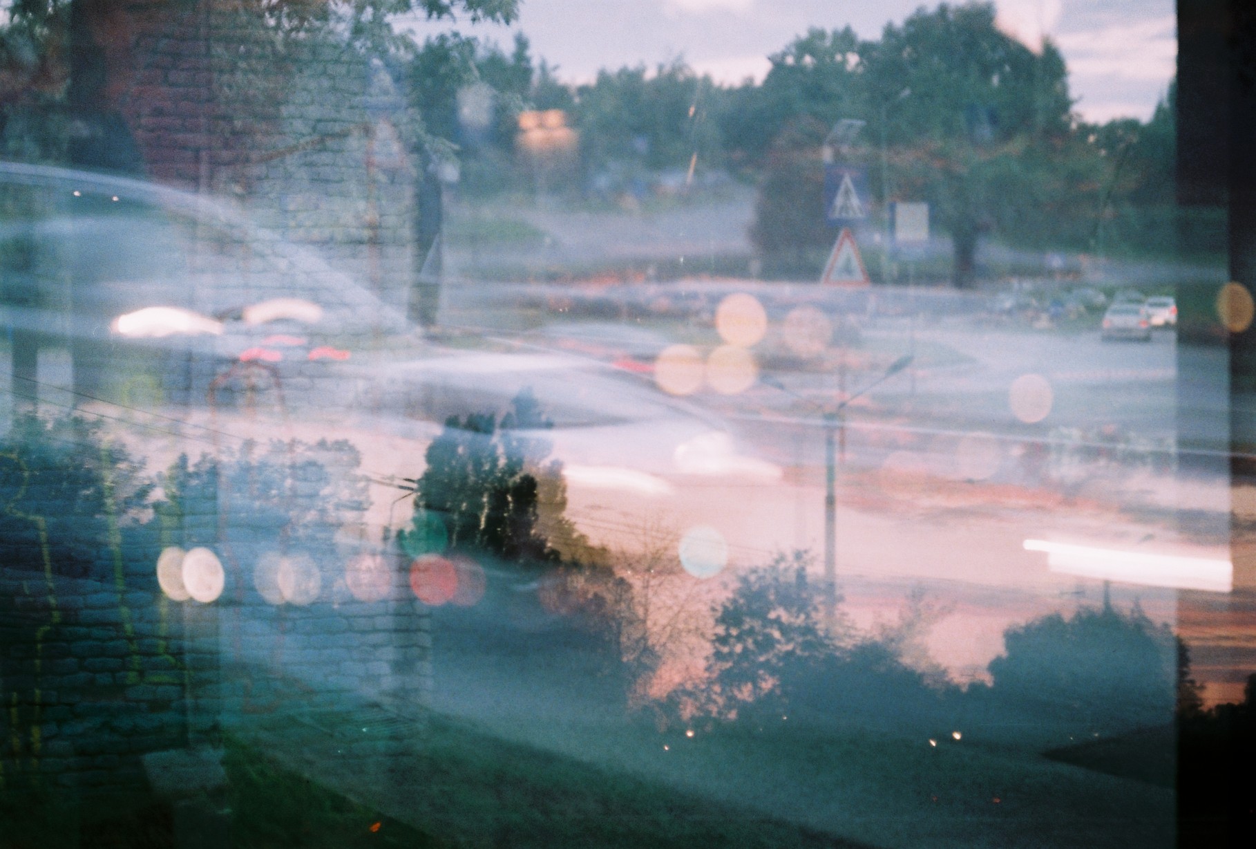

Hello,
I'm pretty new to film photography and I have some issues with my camera.
I noticed that the distance between my photos on the film gets bigger as the photos advance. For example the firs 3 pictures have somewhere around 1 cm distance between them whereas the last photos have somewhere around 3 cm or more. Also I noticed that the last photo from the film is always double or triple exposed.
So because of this lots of photos are ruined and at the scanning process the scanner cuts pieces of them. Also I can't know when my film is over.
I attached two photos for a better example.
Kind Regards!

It could very well be that the clutch on the wind spool is at fault. It has to slip when the film is rewound but not slip when it's advanced. Access to it would be under the advance lever and wind gearing.

But at an MTL the advance is controlled by the sprocket wheel anyway. And that should run at fixed rotation by construction.
I assume the disengadgement of the sprocket wheel (for rewinding) by fault is on constantly and the film is transported instead by the take-up spool. Which leads to a frame spacing that is growing and too large from the beginning.
Though that would not explain those double exposures.
I assume thus that disengaging variably affects just the sprocket wheel or the whole transport chain, which would lead to the result you have got.

Normally at the end of film there would we resistance via the sprocket wheel at the transport Lever. (Further engaging it would lead to tear of perforation) indicating that the film has come to ist end.
In case of by fault film being transported by the take-up spool, at the end of the film that clutch, that I described above, comes into action. You will feel not much more resistance and erroneously expose one frame onto the other in sucession.
