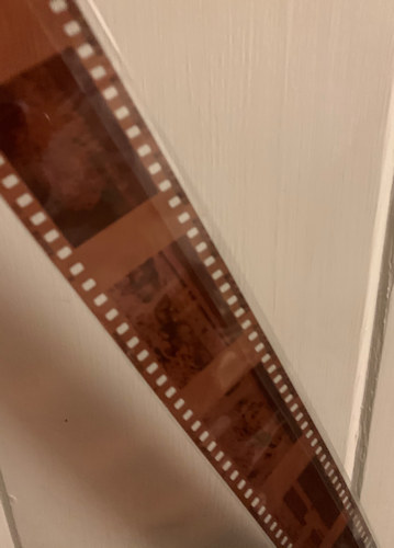

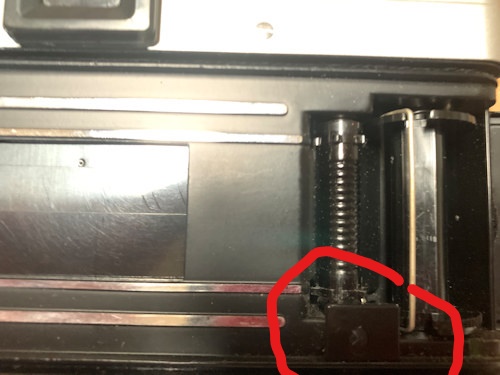

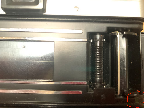

Sorry for the long post but here we go -
I just developed a roll from an LTL3 that I got from Ebay. The frame spacing is too wide and gets larger as it goes on with every frame.
I've read other posts saying that this is a problem with the film sprocket not moving the film properly, and the take up spool only moving the film.
I would imagine that if this was the problem then the spacing between frames would not be as even as in the photo. The takeup spool would fill with film and so the spacing would be bigger. (just a thought)
The film spacing does get bigger and bigger, slightly, over the course of the film, my picture shows a small part, but it does grow larger along the course of the roll.

While loading the film, I was careful to follow the direct instructions, and noticed that the film sprocket wheel did not actually seem to move the film using only the bottom half of the film sprocket wheel, it did a little bit, but after the film was grabbed by the take up spool rods, it moved along with the film sprockets.
I also noticed that one of the film sprocket wheel teeth was missing from the lower part.
The problem is the lower half of the film sprocket is cracked or a piece of plastic is cracked off in the lower part of the sprocket. This issue is caused by forcing the film advance lever at the end of the film roll. This is a very common problem with L series Prakticas. There is a kludge for the latter condition but I'd just send it back to the seller.

-) can one see this in the photos above?
-) I myself have not yet come across this fault
-) it still does not explain what the OP experienced in handling the transport mechanism

-) can one see this in the photos above? -) I myself have not yet come across this fault
I bet if he puts his finger on the take-up sprocket it will slip. when he advances the film lever. If it does, one of the 2 conditions I stated is the problem
The inside of the takeup sprocket is cracked from forcing the advance lever at the end of the film roll. A very common Praktica issue. I would try to get my money back.
