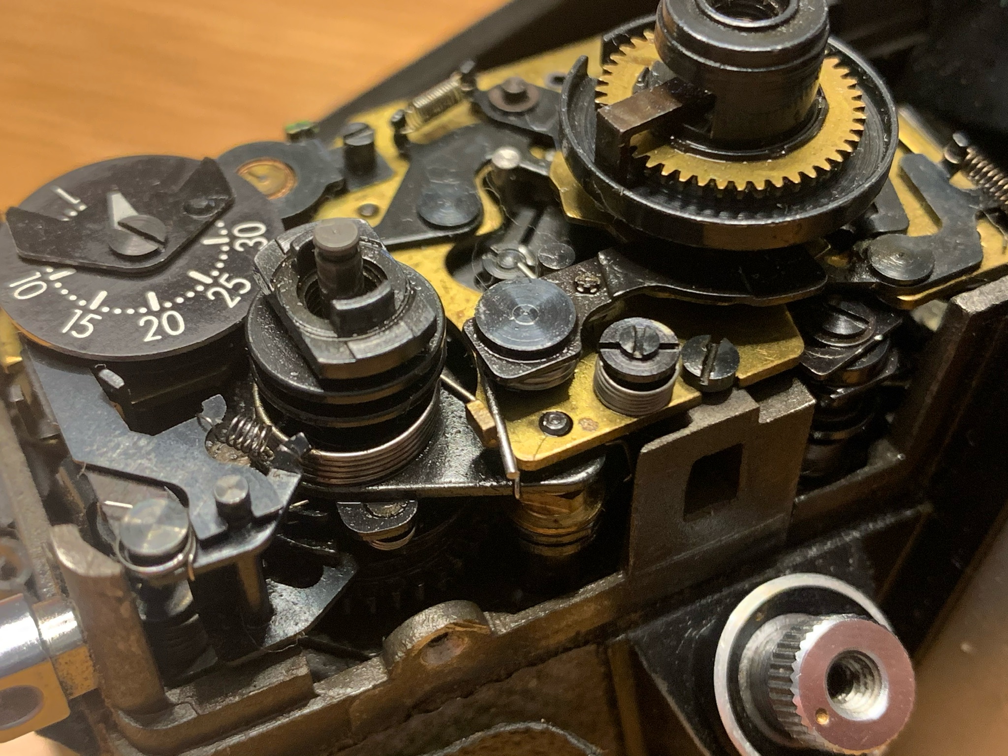

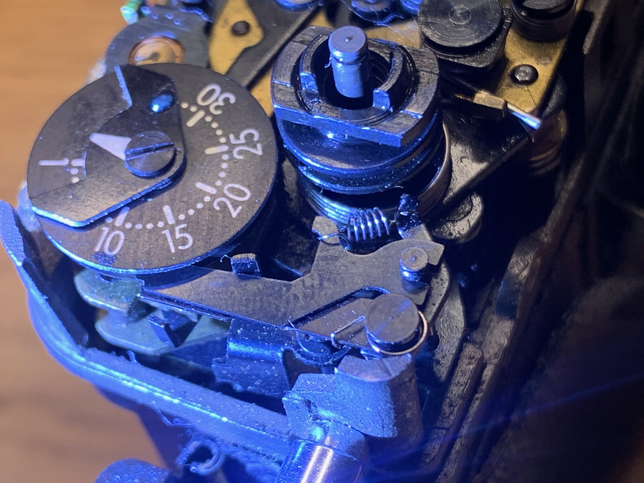

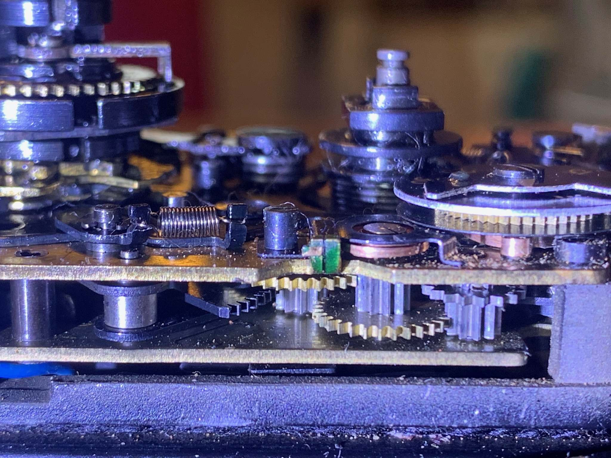

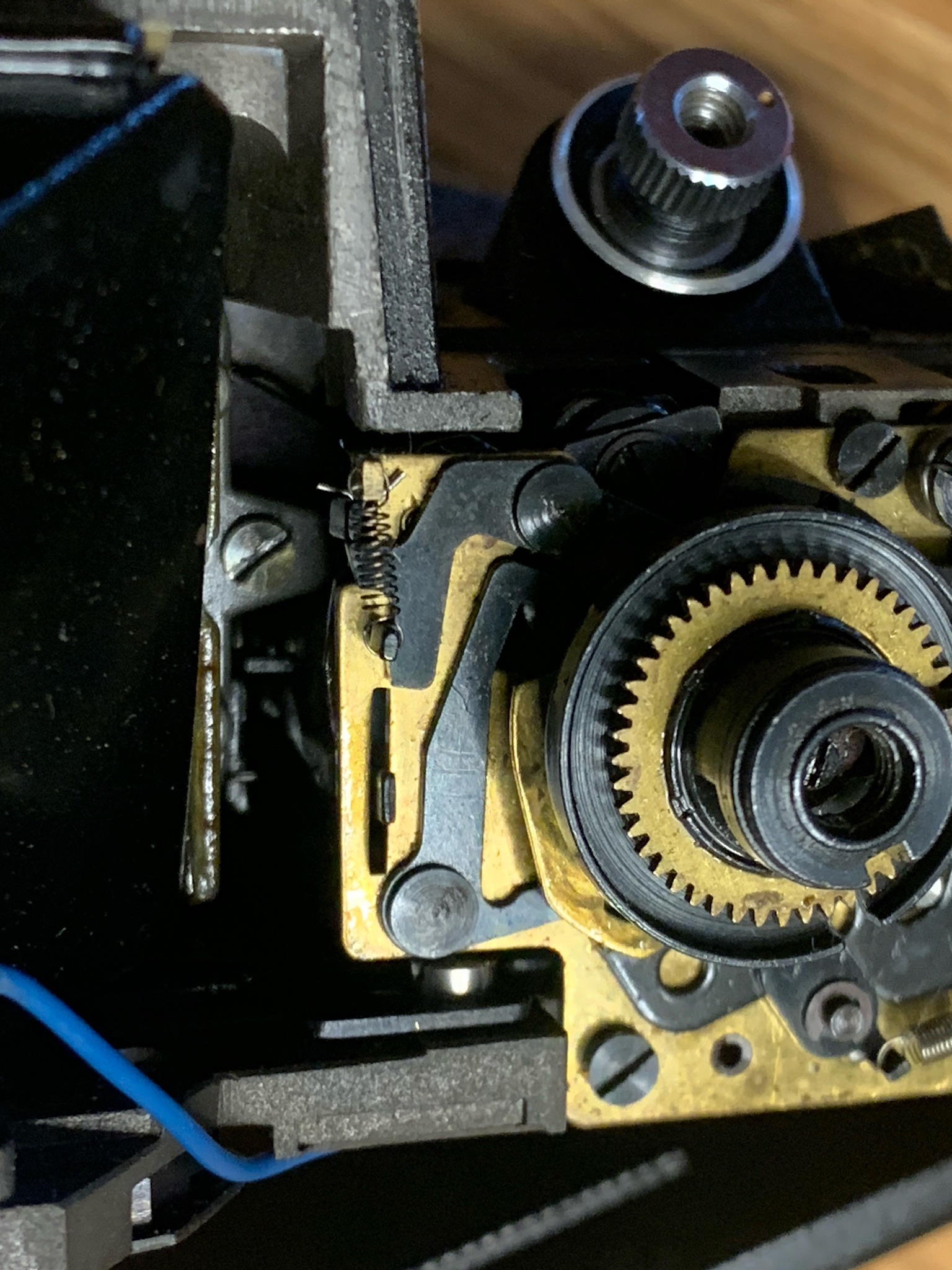

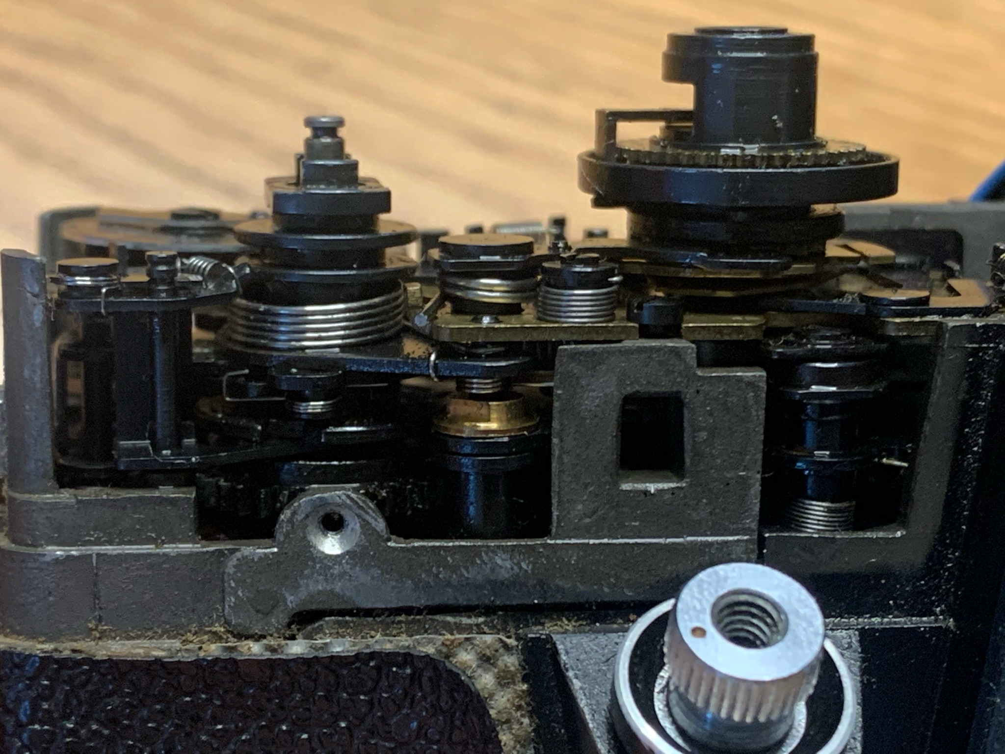

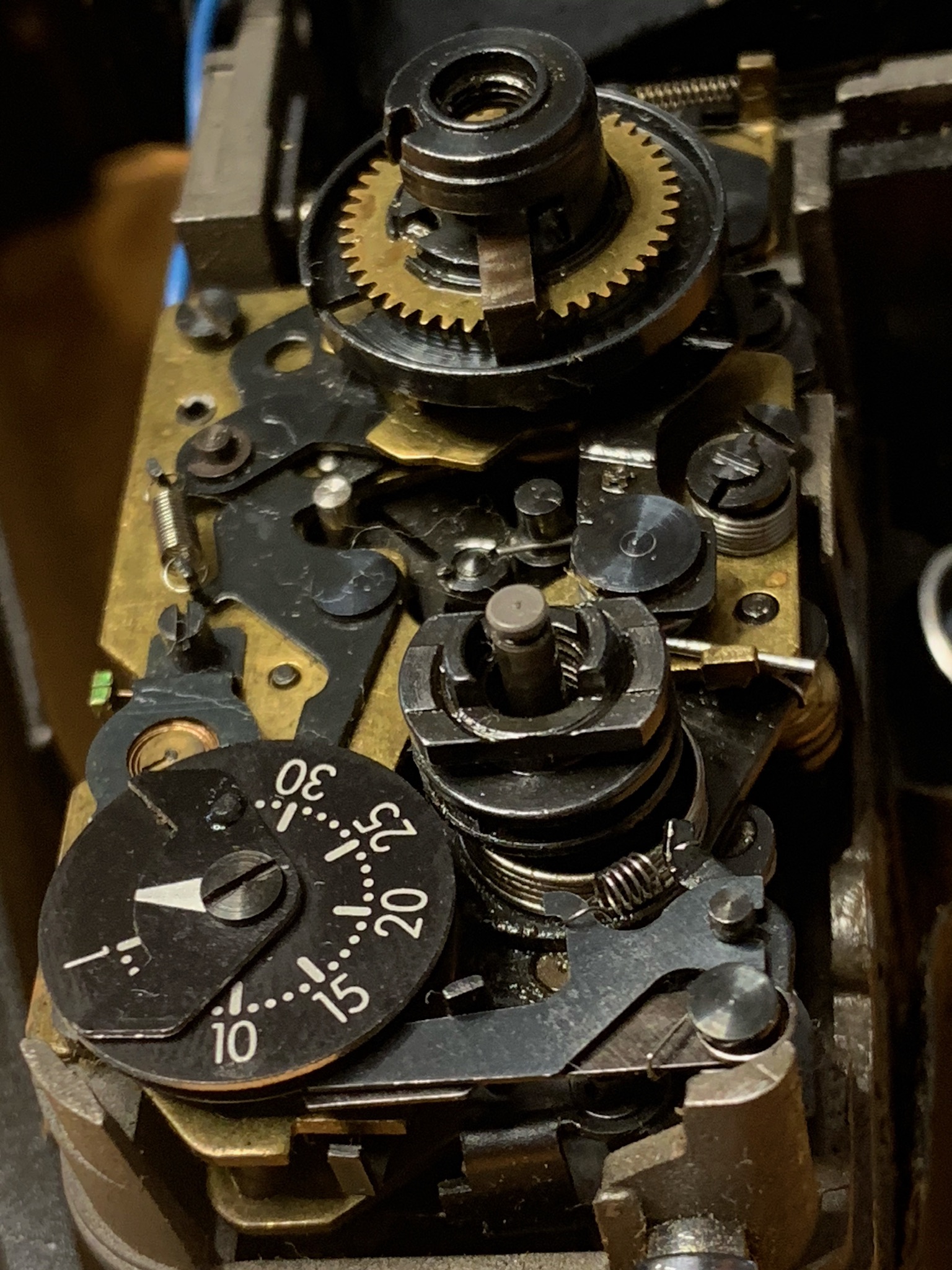

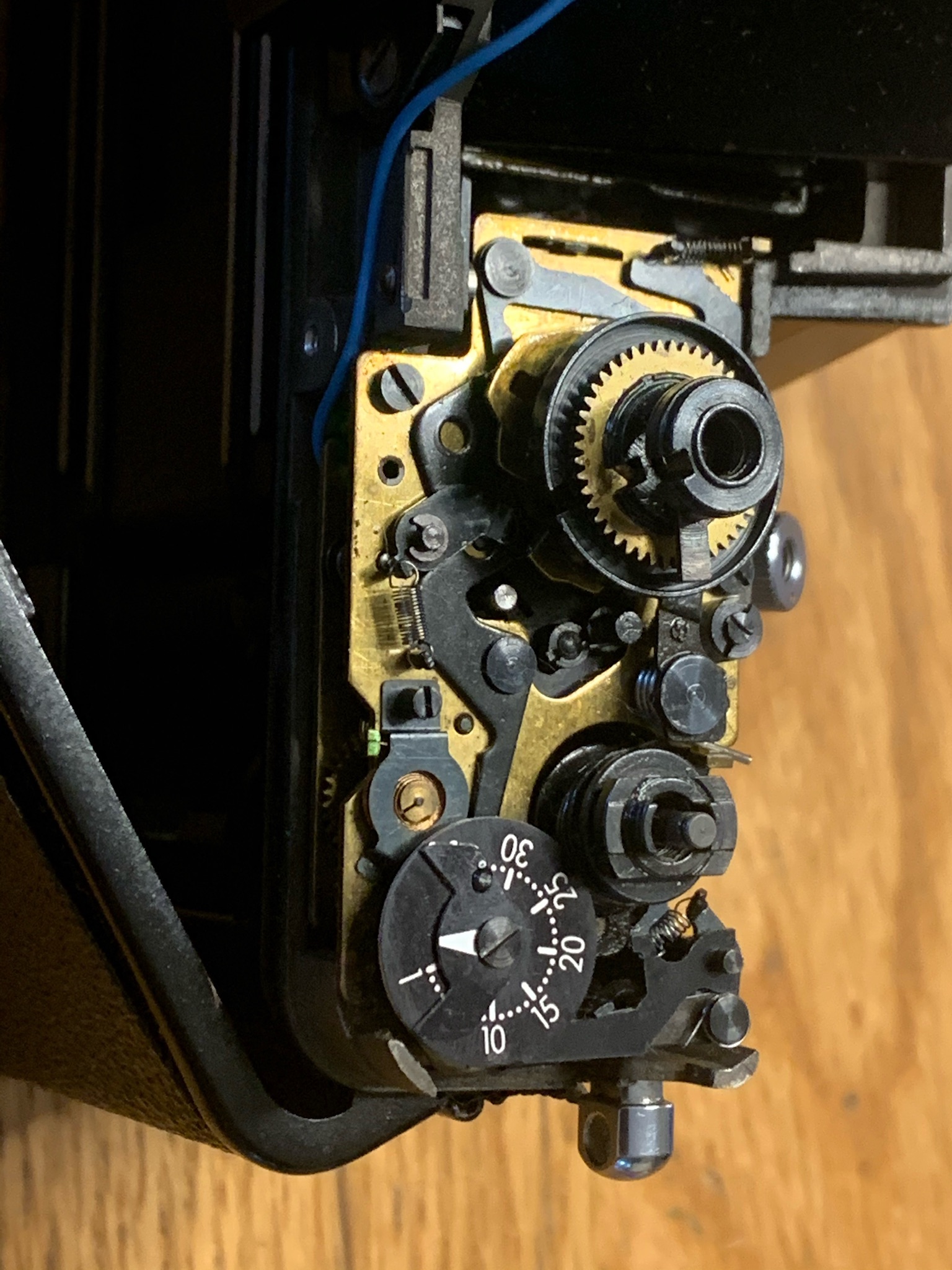

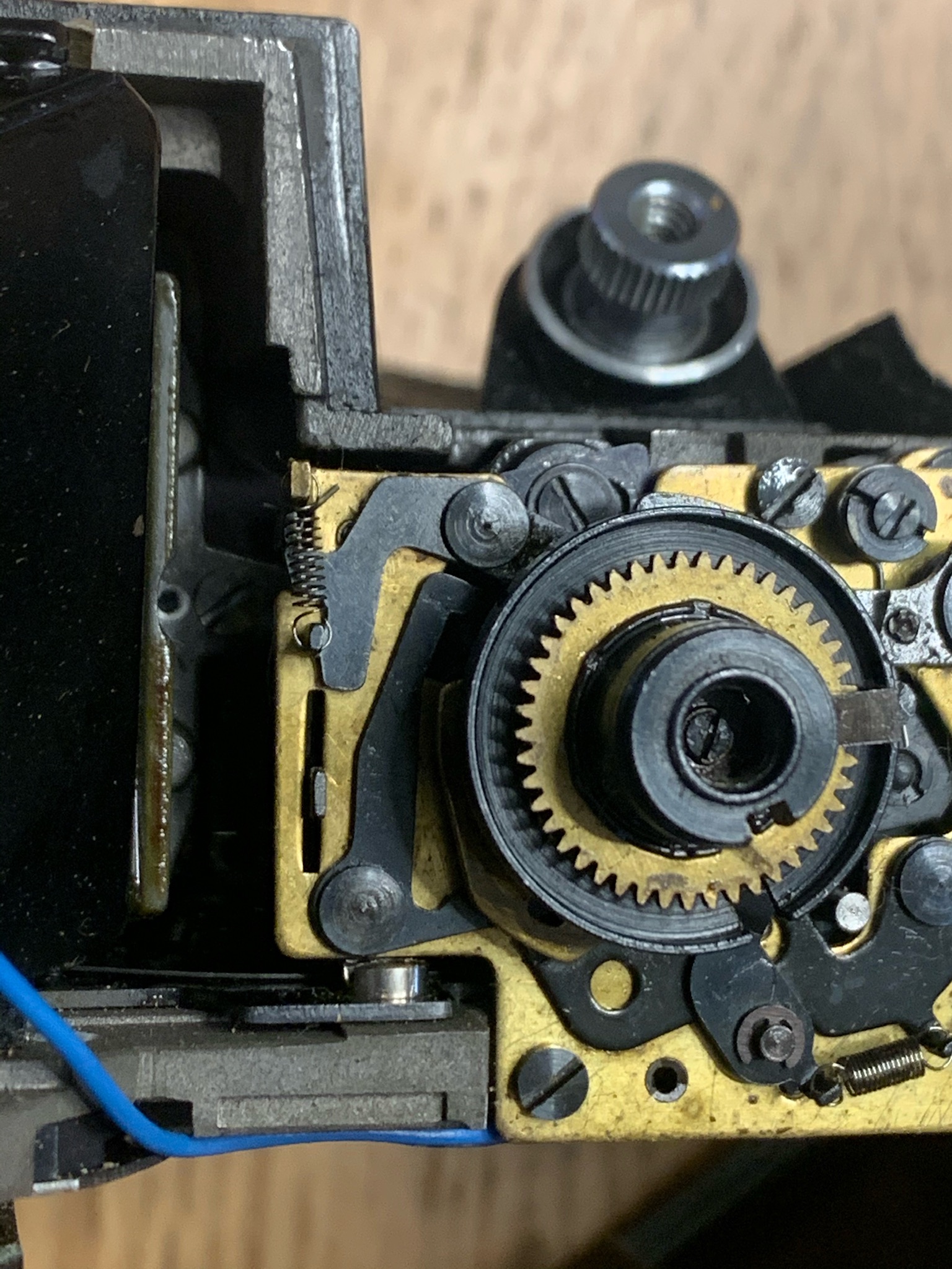

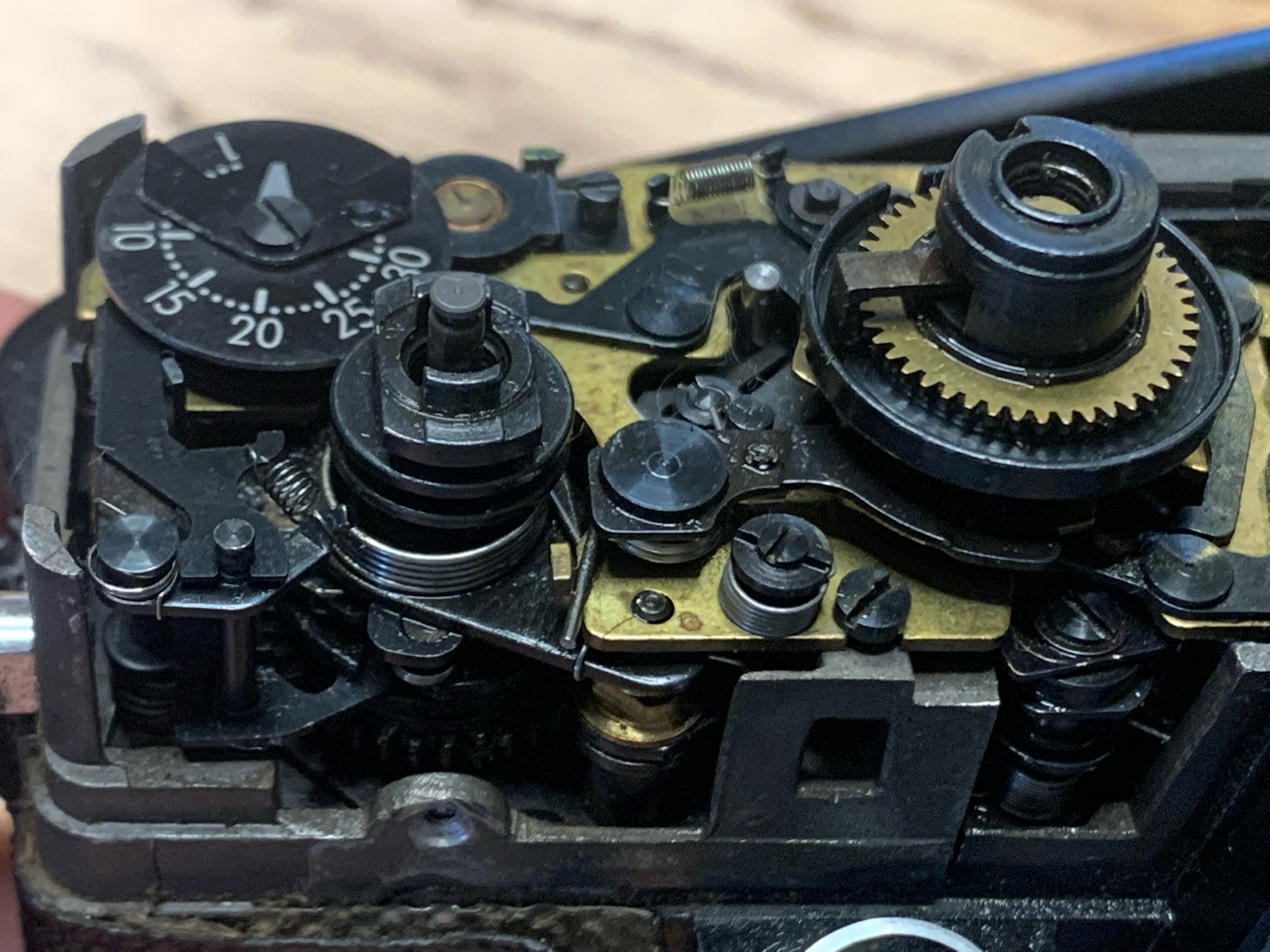

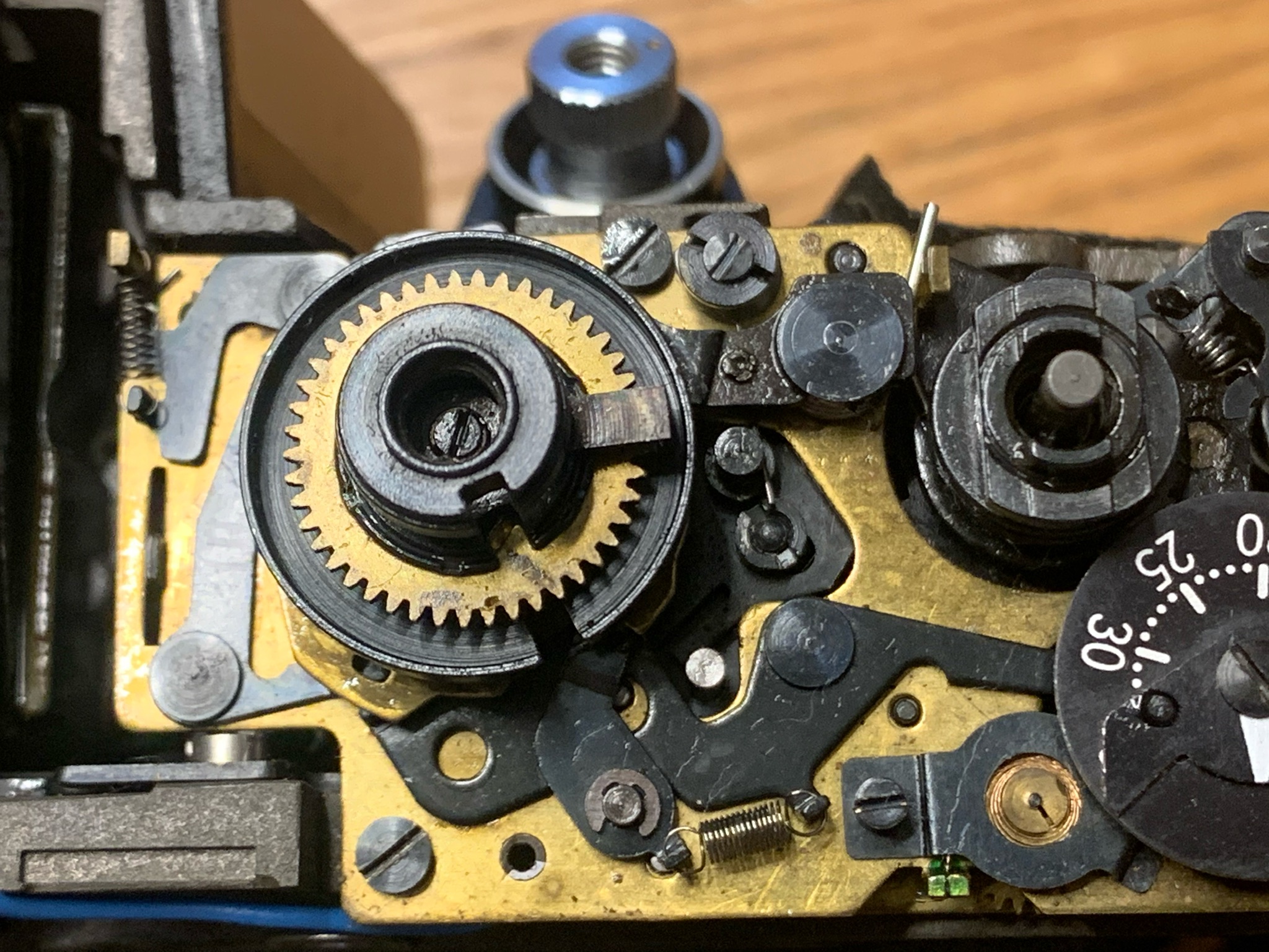

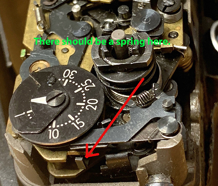

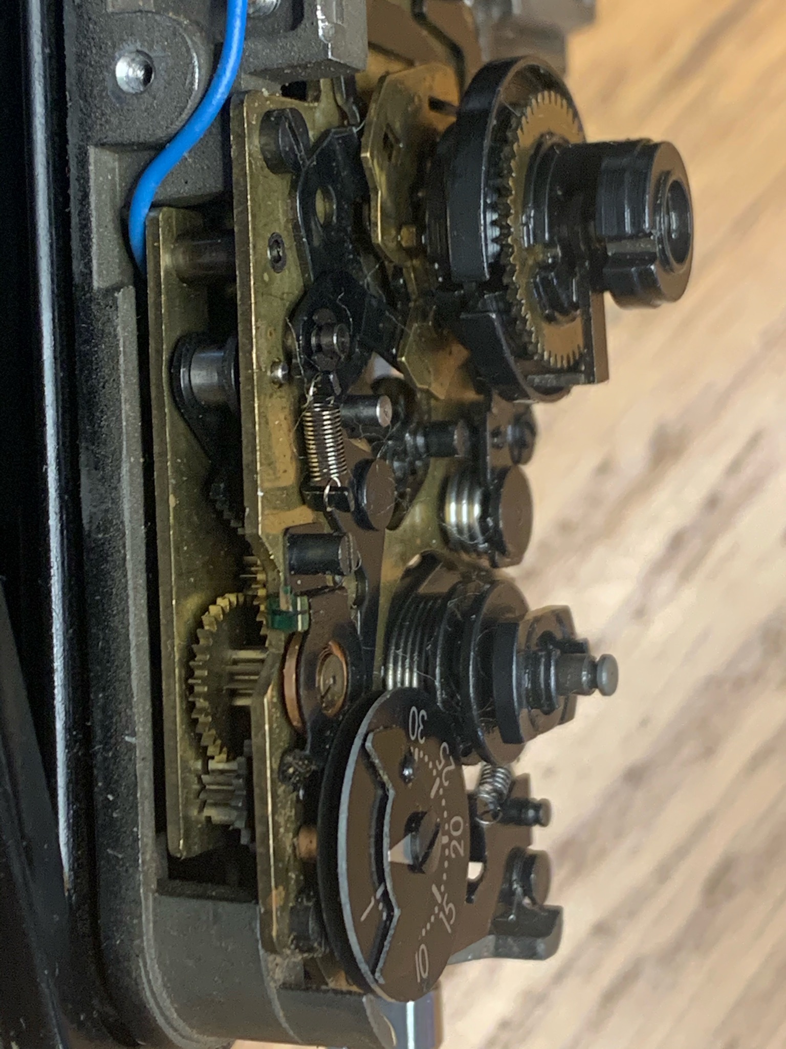

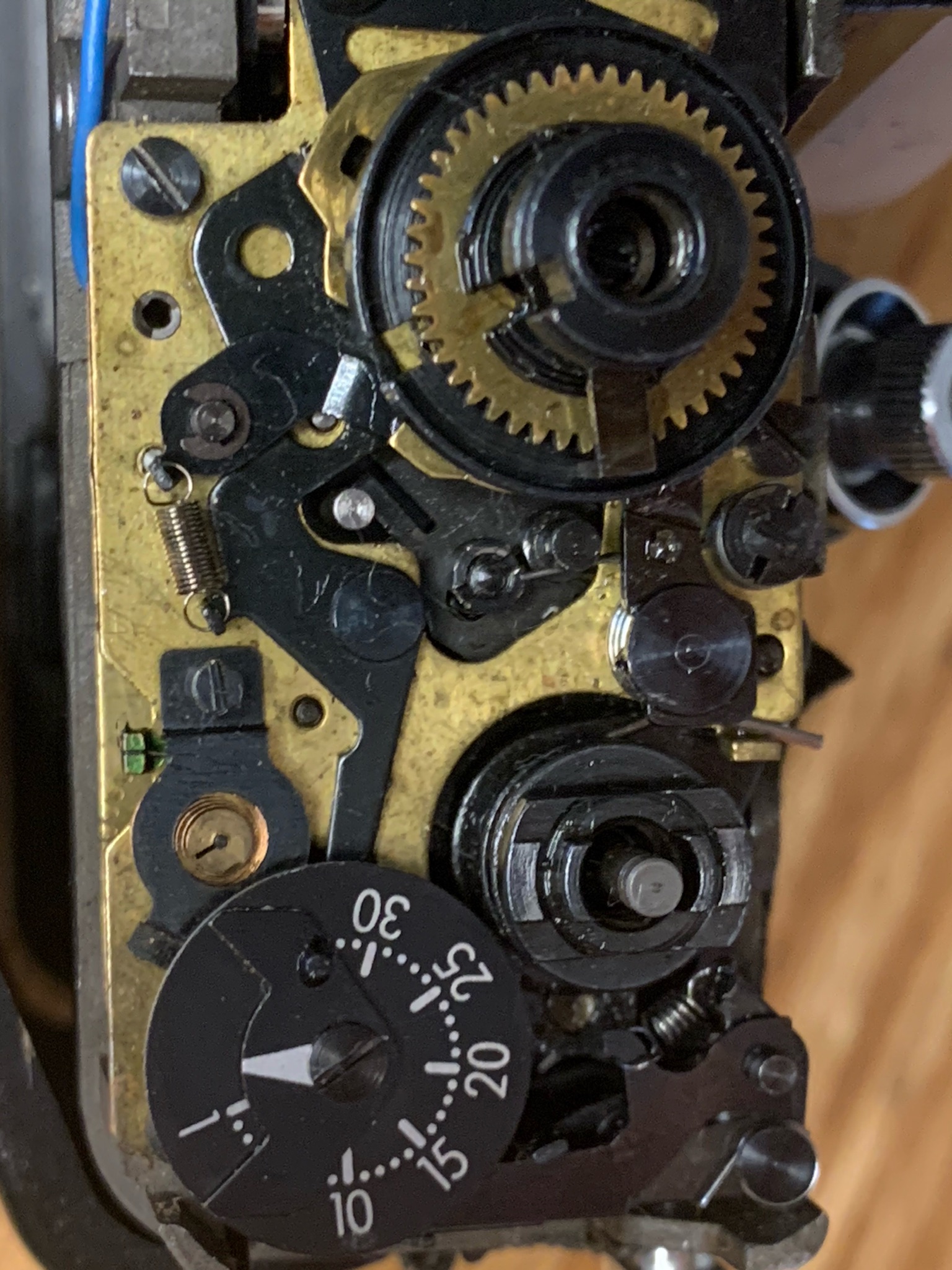

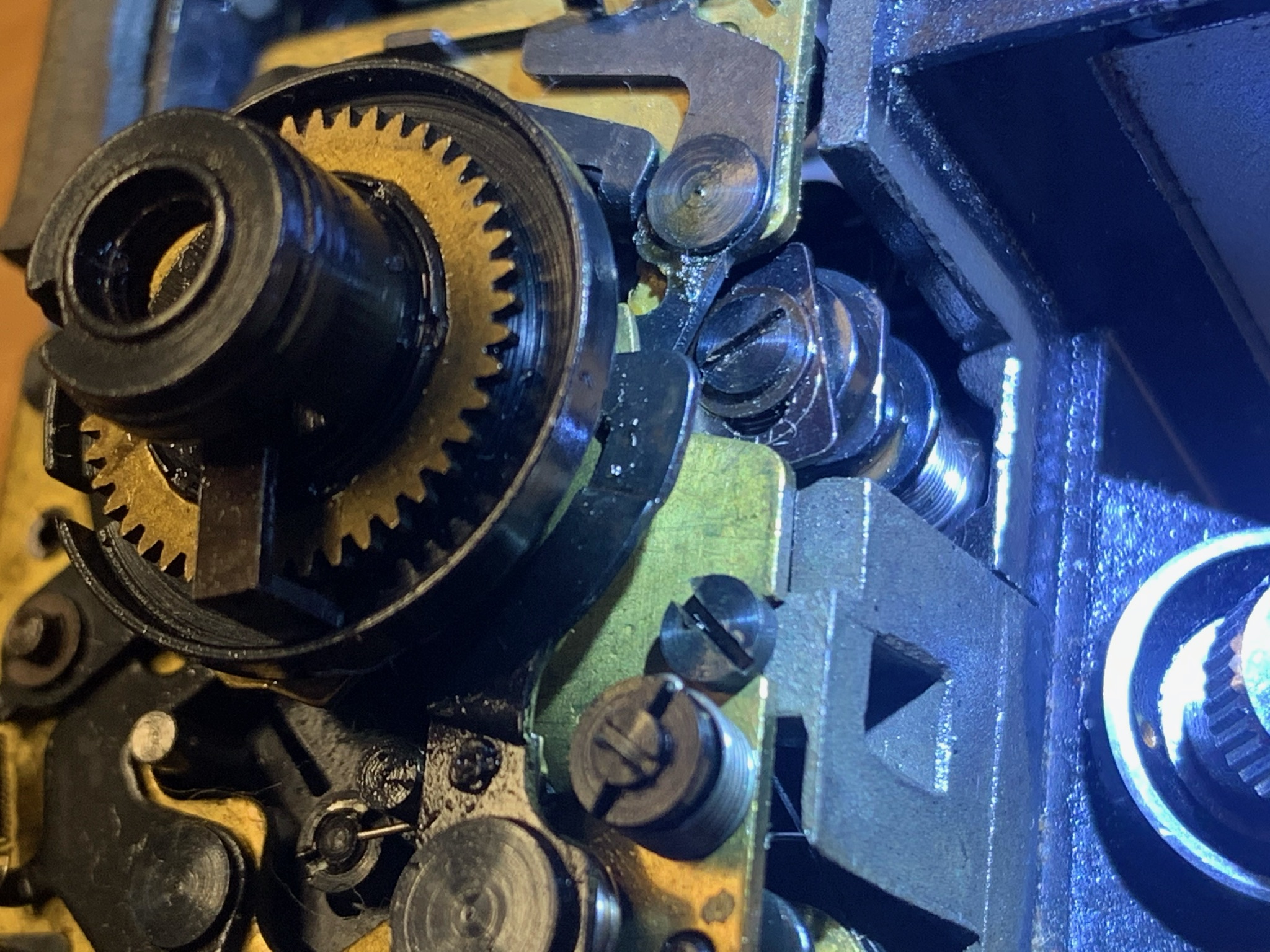

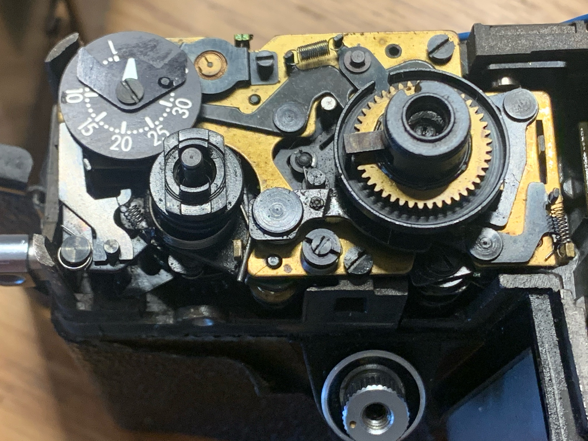

I’m trying to follow this advice to repair an old Praktica LLC but I was wondering if anyone could guide me in the right direction with how to remove the slow speed mechanism / assembly ( escapement ) .
“..Had a similar problem and fixed It by removing the top cover and slowspeed assembly to reveal a shutter adjustment lever that can be reset by loosening a screw and pulling the lever towards the cocking mechanism“
The article goes on to mention ... “in his case (and mine) it didn’t adjust far enough and required bending the speed steering mechanism slightly”
Wondering if anyone has seen similar or knows how to do this?
I’ve attached as many pics as possible to hopefully make things easier to identify

sorry, I didn’t explain fully, when attempting to cock the shutter, the shutter is locked and will not allow advancement, if I depress the shutter release, still nothing. Inside the front, there is a little latch on the left that releases the mirror from being ‘locked’ in the fully up position, and even if I press that latch the mirror is still in the open up position, and while I can now push it down with a finger manually, it springs back up.

View attachment 280953 View attachment 280959 View attachment 280959 View attachment 280960 View attachment 280962 View attachment 280953 View attachment 280954 View attachment 280955 View attachment 280956 View attachment 280957 View attachment 280958 View attachment 280959 View attachment 280960 View attachment 280962 View attachment 280963 View attachment 280964 View attachment 280966 View attachment 280967 View attachment 280968 I’m trying to follow this advice to repair an old Praktica LLC but I was wondering if anyone could guide me in the right direction with how to remove the slow speed mechanism / assembly ( escapement ) .
First, take the bottom cover off and note where the wiper on the large potentiometer is located. Note where the L lever inside the shutter speed assy is located Then unscrew the L lever and remove it. Next, unscrew the counter and move the 2 levers away from the counter dial while pulling up the counter dial and spring. You will have to wind the dial up when you put it back on. The levers will hold it in the wound-up state. Remove the 3 black screws that connect the speed assy. to the chassis. Gently pull up on the speed assy. Sometimes it sticks. I like to put a small amount of powdered graphite on the bearings in the speed assy when it is off the camera. Put the L-shaped lever in the exact same place as you tighten its screw. Make sure the bottom potentiometer wiper hasn't moved after tightening the screw. Not fun but I've done it many times when I was younger.
