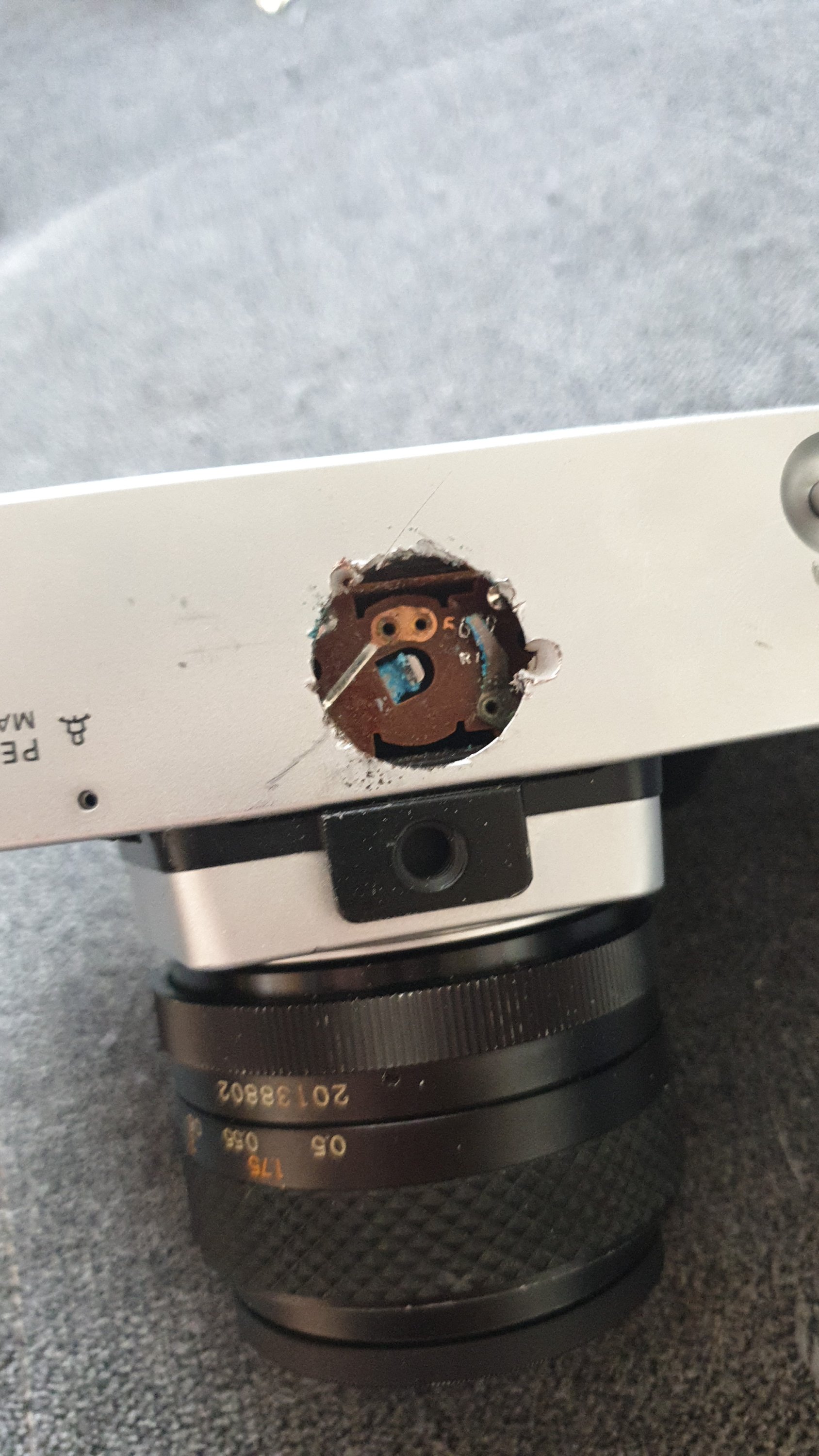

Update: i have drilled two small holes around the battery slot (only way i could free it) and took out the corroded battery. the battery cap and the enclosure it has to screw into are sitting in an industrial chemical which seems to have eaten away almost all the mercury (don t ask, not even i know what this forsaken, hungry chemical is).
now remains the issue of the electronics, they have a bit of a blue mercury coating, pretty thick too. I am kinda scared to clean it. What shall i use? 99% rubbing Alcohol?
i am too scared to use my wonder chemicals there, they may destroy the electronics..they are marked as caustic after all.
Thoughts?

You couldn't get the battery out by removing the bottom of the camera?
sadly no, it was too corroded at the time. the chemicals however managed to melt the mercury oxide into a fluid state so i could free the battery and the cap from the plate.
Thoughts?
Use naphtha. Isopropyl alcohol will melt the plastic gears that drive the large meter potentiometer. They are coal based and will turn to goo almost instantly. I had repaired a L series camera and decided to do a final cleaning using alcohol. Bad, bad mistake.
