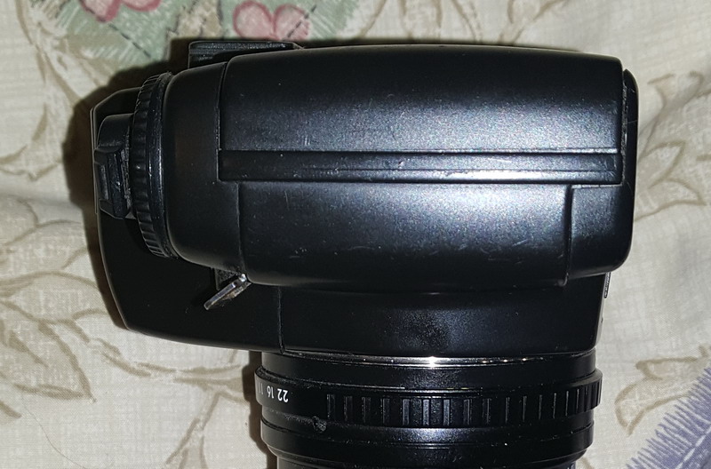

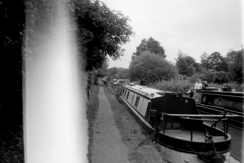

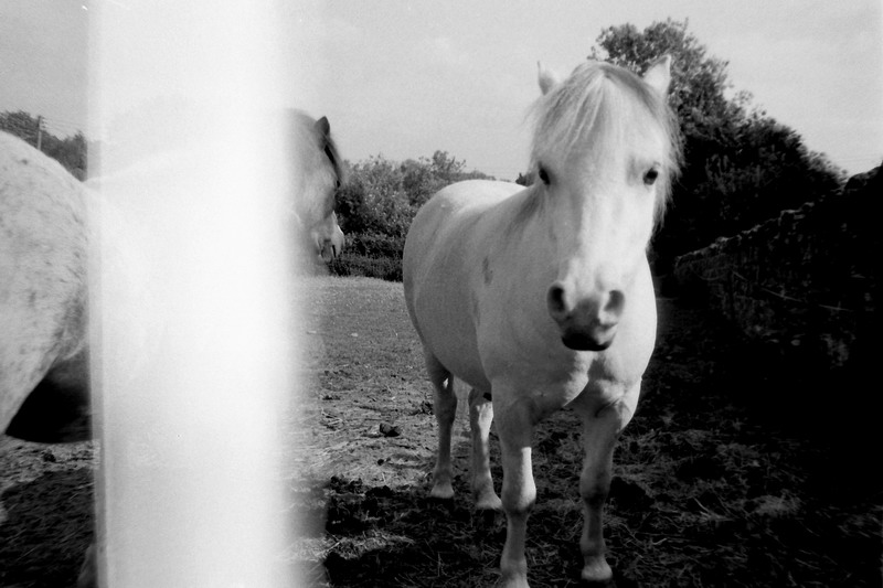

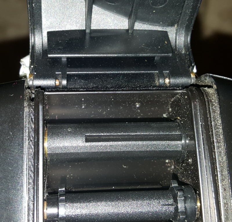

After flawless performance since new in 1993, my Praktica BX20S has developed a light leak. I have attached a couple of photos to give an example. It seems that the bottom of the frame is worse, suggesting the leak might be worse at the top of the film chamber if my understanding of optics is correct. The camera was fine up until March 2016, when I shot a roll of Ilford Delta 3200 without any issues. Then in May/June 2016 I shot a bulk rolled cassette of Fomapan 100 and a bought cassette of Acupan 100, with the same results. The light leak. Photos taken in a dark church were fine, so it's definitely a light leak.

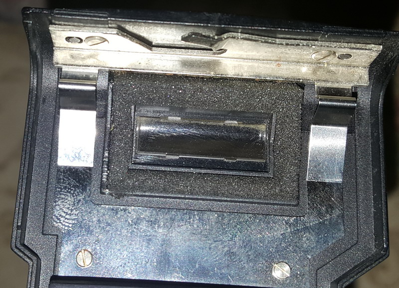

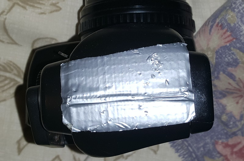

I have since gaffa taped the brass clasps, and shot a quick test roll. The leak is still there. The foam around the window seems fine. Indeed I cannot see any problems. Does anyone have any ideas?

The solution for the light leak is simple: remake all the seals, kits online are cheap.

Does the over exposed band extend into the the rebate area of the film? Yes-light leak> probably the film window so block it. They are a common problem source.
No>shutter problem, probably needs a CLA.
B200 possibly need the shutter serviced also.

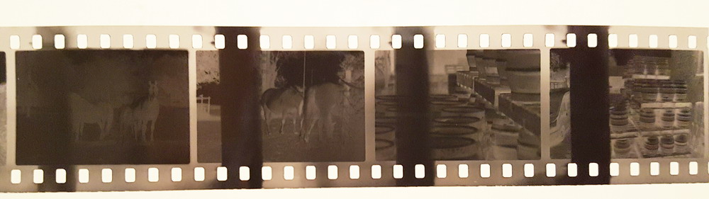

The fogging is a vertical area which affects the entire film, as seen in the attached photo of a strip.
Yup, light leak IMO.
but it looks like a problem when you were loading or unloading the camera, are you sure the cassette wasn't exposed to light? Is that the only film with the problem?
If the problem are the seals you can easily replace them, as an interim solution you may shoot with the camera in the half case, in many cases it helps.

The film window foam looks good, but I can quite easily try a quick test roll with something opaque stuck over the film window to see if it helps.

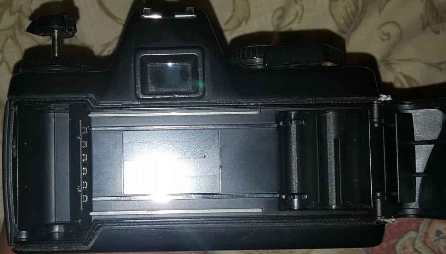

Lay a strip of the light leak film in the camera with the top of the image at the bottom, emulsion facing the curtain, and the frame aligned on the curtain opening.
There are two possibilities for the leak, the film window and the back hinge. The pictures in the user manual looks like there is an overlapping metal flange light trap system in use at the back hinge and I doubt seriously the leak streak on the film ever lines up with the back hinge but the light leak streaks will align with the exit edge of the film cassette.

Shutterfinger, that's a very clever idea. On trying your suggestion, the light leak almost matches the hinge but it is a 100% match for the exit of the film cassette.#
My next step is going to be to cover the film window and shoot a few test frames while leaving the camera in the light somewhere...see if that solves it. If it is the film window I can repair the foam seals properly at a later date.

Just a quick update, with three layers of gaffa tape over the film window, and the camera left in direct sunlight for several hours, the result is no light fogging.
Many thanks, I've now been able to identify the source of the leak and affected a temporary solution. I can now replace the foam if I want something more elegant...but importantly my favourite camera is back in action.
