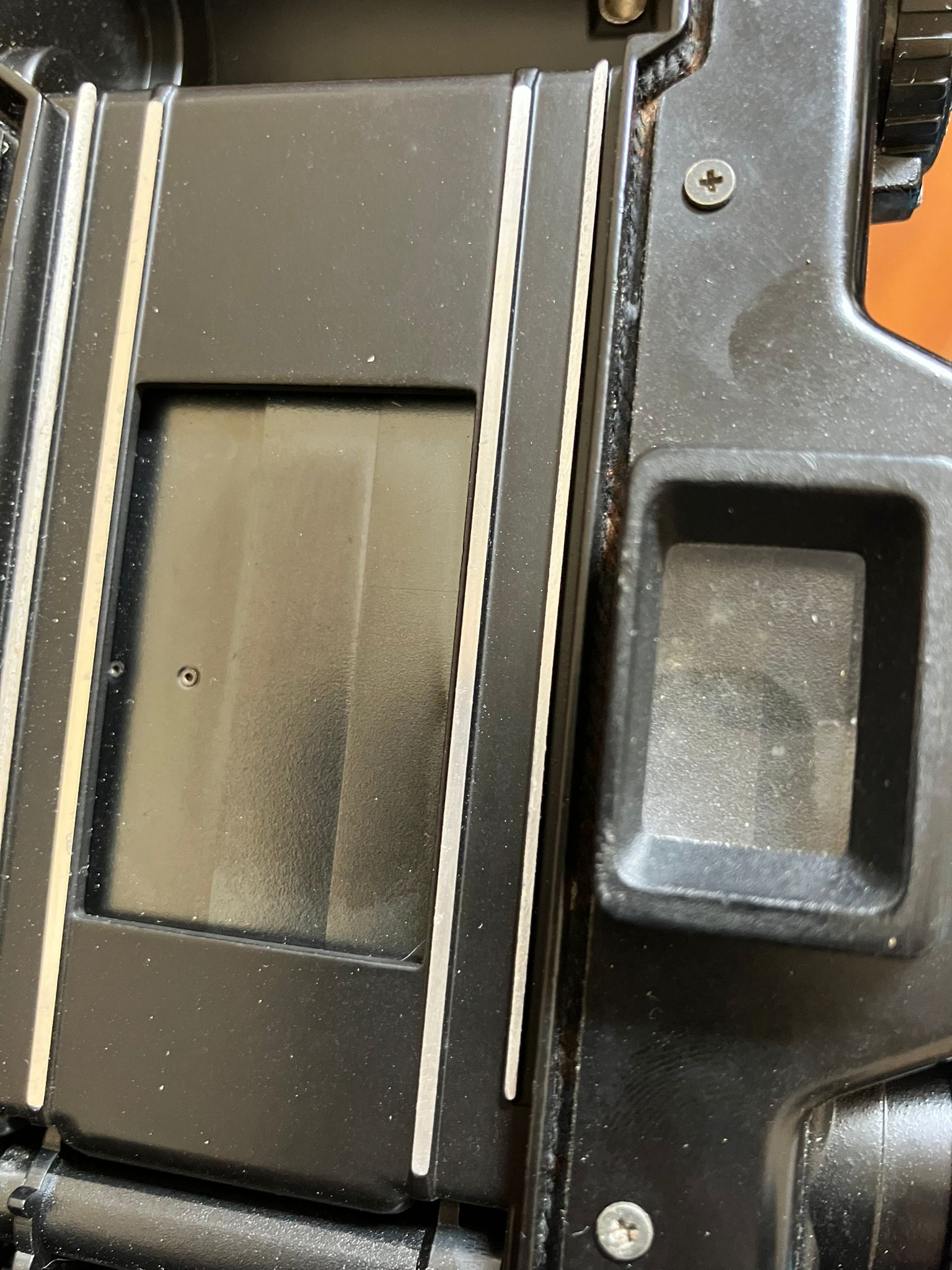

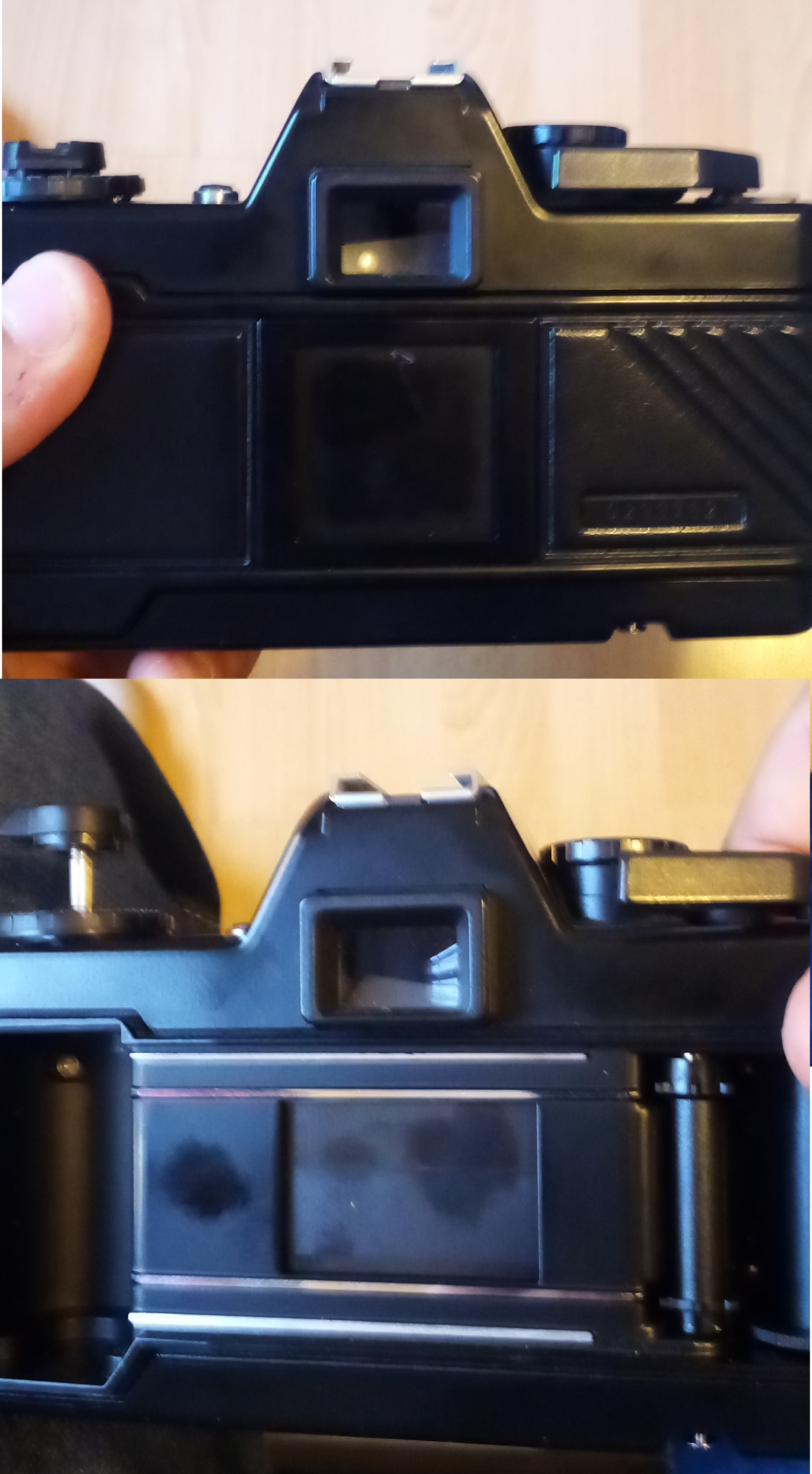

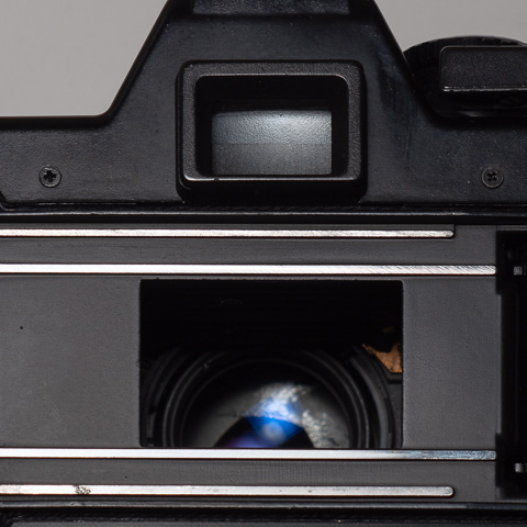

I recently bought a Prakitca BMS electronic that was supposed to be in working condition, but there appears to be a problem with the shutter. The aperture blades don't open, and one of them appears in the viewfinder (it moves around when I use the film advance lever).
I have already fixed stuck aperture blades in an Olympus Trip 35, so I am somewhat confident I should be able to take this one apart and access the aperture blades (I've found videos for similar models), however I am not sure what I'm looking for. Do you have any idea? The blades are not stuck, so what could it be? A broken spring?
Also, the mirror goes up and down when I advance the film, but it does not when I try to activate the shutter. There is a small click sound, but nothing seems to happen. Could it be just one single issue, or two separate ones? Or maybe I am just misunderstanding how it is supposed to work, since I've never tried fixing a reflex camera before.
