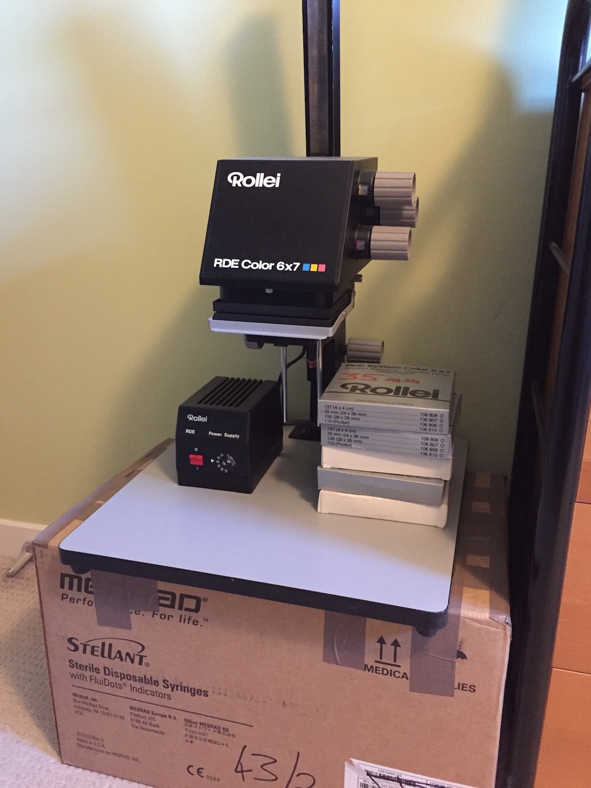

Hi there,
I was out shooting with my Rolleiflex a couple of weeks ago when I was approached by a gentleman who said he used to own the same camera. We got to talking about darkroom printing and, to make a long story short, I ended up going home with a new-to-me Rollei RDE 6x7 Colour enlarger (which I think is made by LPL). Needless to say, I was very excited; I would finally be able to print at home rather than in the public darkroom in town.

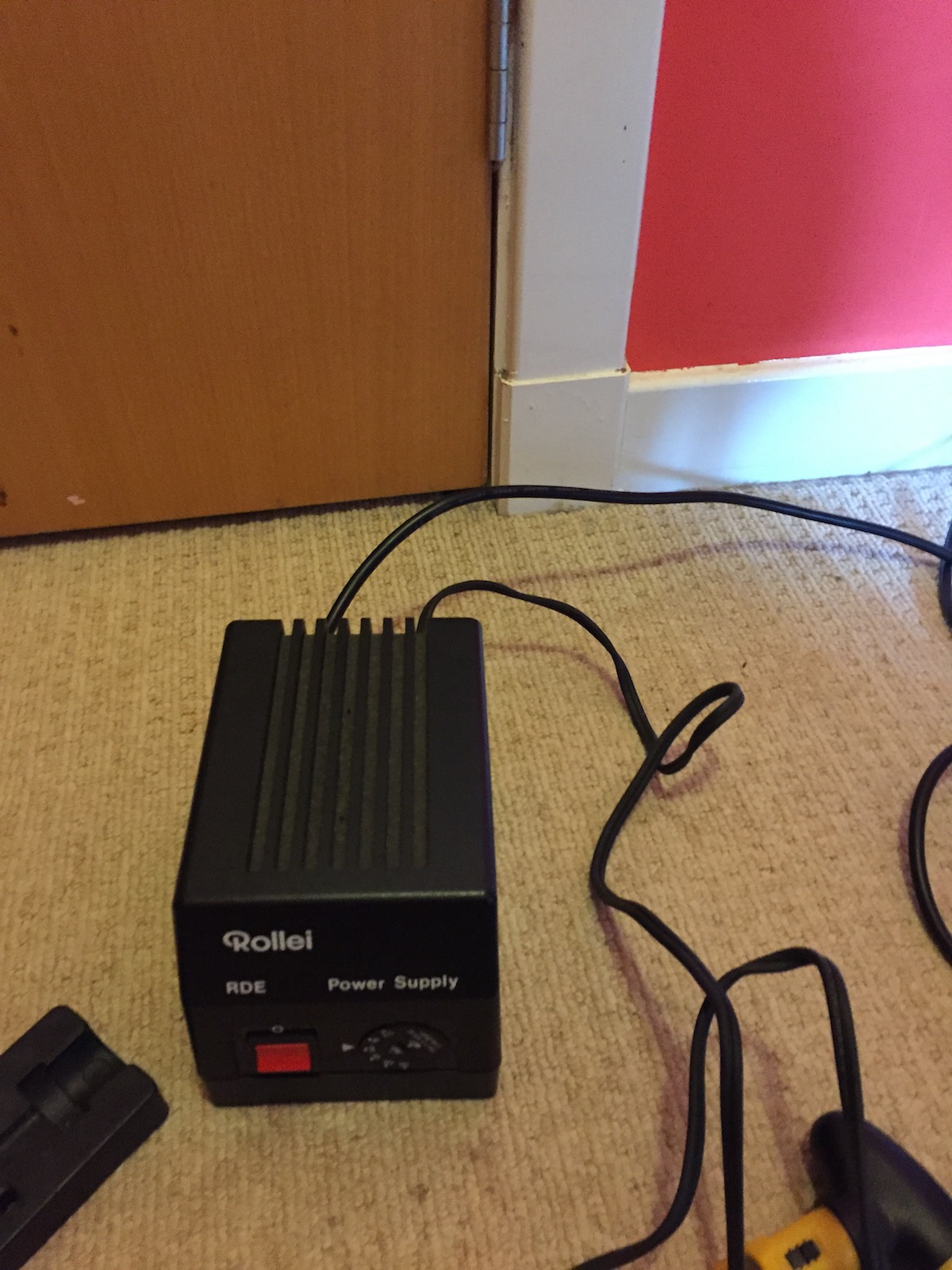

The kit looks great and all of the negative carriers are there, but there seems to be an issue with the power transformer thing. Using a voltage checker, I can see that power is going into the transformer but nothing is coming out to feed the enlarger.
Any ideas about what I can do?
Can I swap the transformer? I see that someone in the UK is selling an LPL transformer/power supplier; would this work for me?
Any help or advice would be much appreciated!
Thanks!

There should be a "Rating Plate" on your Rollei RDE Power Supply. What does it say? What symbols are close to the figures? That should tell you the input voltage range, whether the output is AC or DC, and what the voltage is. Is there a fuse? Has it blown? Good luck, it looks smart.

What is the knob on the front of the power supply? Where does the timer connect? Where, and under what conditions did you measure the output in AC to determine it was zero? Is there a fuse? Does the manual give any troubleshooting hints?

Wow, thanks for all of the advice. There is quite a bit to think about.
I am away for a couple of days, so I don't have the enlarger in front of me, but from memory there is a power switch and then a wheel for selecting the power input (e.g., 120V, 230V, 240V) on the front.
I had used a non-contact voltage tester tool to check for voltage. It went red for the power cable into the power supply unit, it was even red when I put the tester up to the power switch on the front, but it did not light up where the cable runs out to the enlarger head.
When I have the enlarger back in front of me again I will check about the fuse inside and also the Rating Plate to determine the voltage, AC/DC, etc. and report back.

To update here, I had a friend who is more experienced in electrical matters and with some better equipment take a look at the enlarger and power supply. He says that the power supply/transformer looks to be working fine, but there appears to be an issue with the cable that runs out from the power supply to the enlarger. I'm going to see if I can replace this cable to get things going.

Sorry, I've only just logged into the forum for the first time since June last year, so never got a chance to update. If anyone is still interested, there was good news in this case. It was a very simple fix, as all that was required was a new bulb and the enlarger sprang back to life. I haven't actually gotten to properly use it yet, as we've been doing quite a bit of travelling recently, but hoping to make more use of it over the coming months. :smile:

If you used a non-contact tester, then any open circuit on the output would say that there is no current flowing--even if the power supply is working correctly, and the cable is working correctly; for example, if the bulb were missing or burned out. So your new bulb makes sense to get it working.
