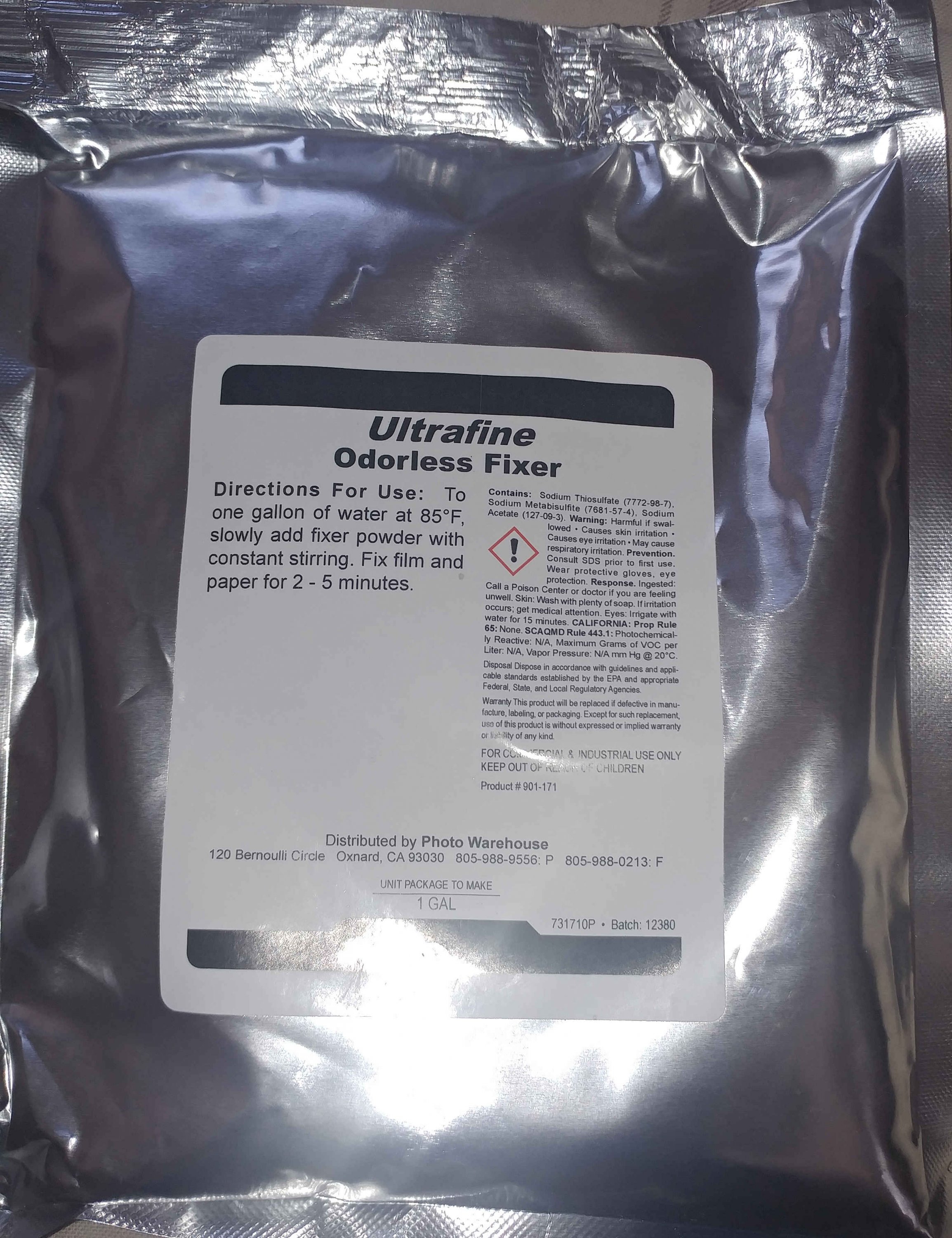

I a new to film developing.
Bought a powder fixer (from ultrafine) see attached.
It is meant to mix 1 gallon. But I need to process just 2 rolls of film every 1.5 months or so (sofar).
I will not be using the 'double bath method'.
My film is always going to be Ilford HP5+ ISO 400, 35mm, shot at box speed.
Is it possible to split into content of the bag into smaller bags (and just mix a small portion of the powder) ?
I do not mind mixing every time before I develop.
If yes, what should be the weight of the splits, and are there any specific storage precautions (I plan to just have the powder in freezer plastic bags).
I searched the forum but did not find any posts on splitting.
The bag with powder weights 708 grams. Without powder 17 grams.
I also measured second bag I had, and that one is 713 grams.
This fixer seems to be 'non-hardening', it has boric acid.

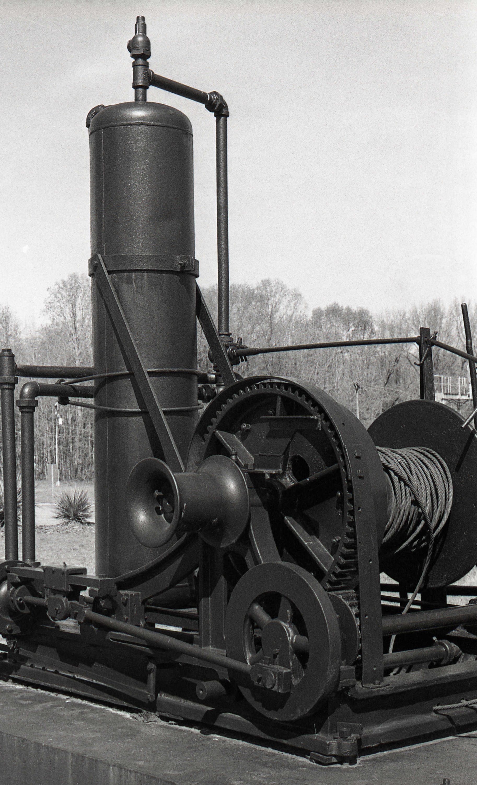

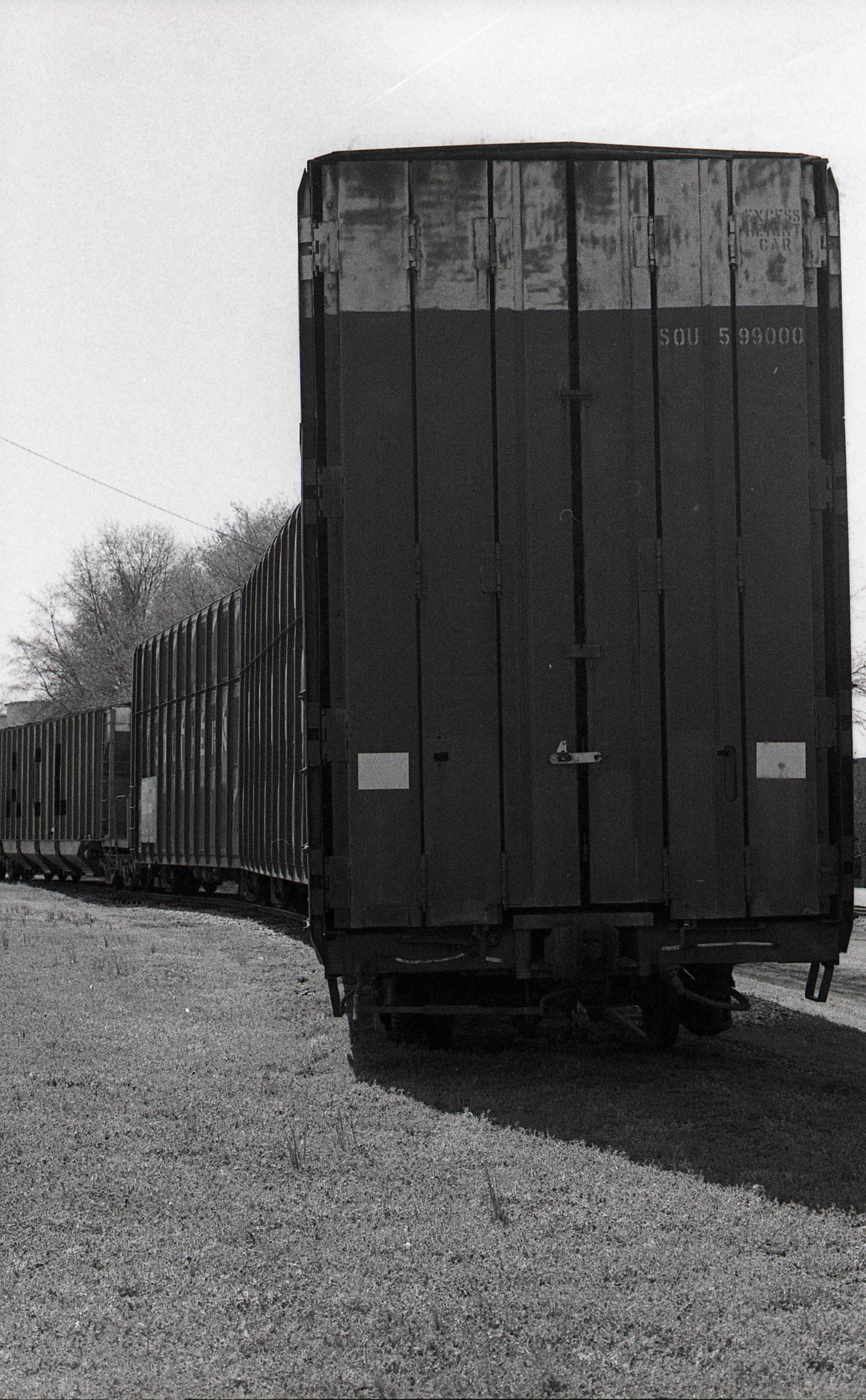

Finally developed and scanned it!. This was 12 years in the making (bought epson scanner 12 years ago or so).
Finally can share some images. I think I overdid the stop-bath (I used 5 ml for 295 ml volume)
But overall, I surprised my family members, that it worked, and i was able to follow through :smile:
tr1-D76-HP5--KonicaAutoReflexT-50_1.4.jpg tr2-D76-HP5--KonicaAutoReflexT-50_1.4.jpg
Konica AutoReflex T2 with 50mm 1.4 (shot at f8 or f11), Ilford HP5+ at box speed, D76-ultrafine at 14 min, Kodak stop bath at 5ml for 295 ml of water, Fixer-ultrafine-powder, no name stainless steel dev tank for 1 roll (made in Japan).
