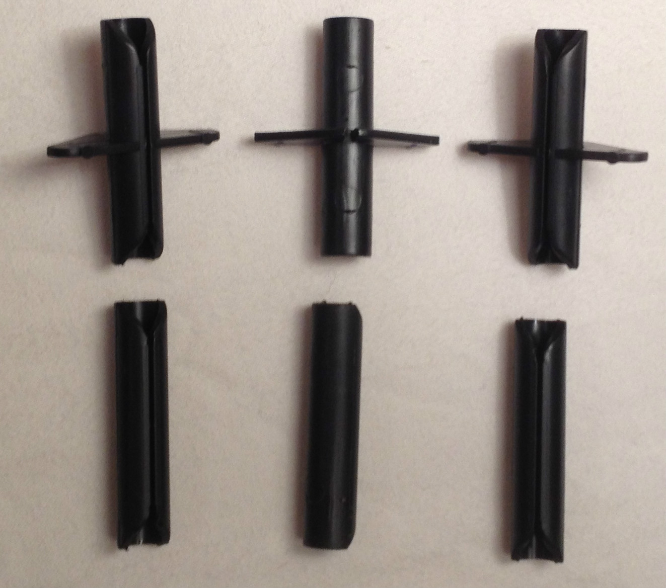

Also, Do you the difference between the triangle shape jobo print clip and non triangle shape one? (pic attached)
Do you use all six of them for secure two 8x10 sheets in jobo print drum? How do you use them?

The clips with wings are used to separate smaller sheets of film so they will not slide over one another.

I tend to do it before and just slip the film down between the ridges as I load.
I also put the clips in to aid in loading sheet film, then take the clips out when I put the lid on. I have had them come loose and bounce around on the emulsion.
