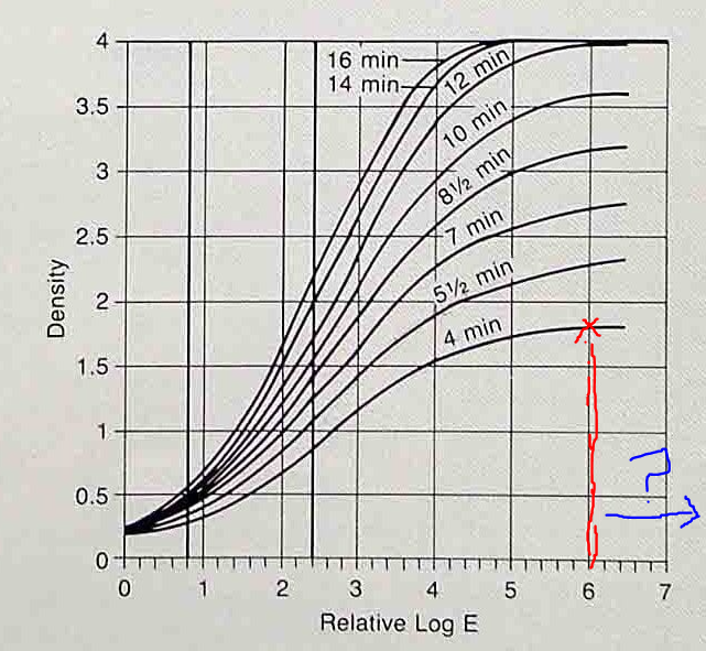

Regarding maximum density of a b&w film, both Kodak T-max 100 and 400 are able to reach densities of 4.00 when developed in D-76 developer (for an extended time). This is coincidentally, and historically the highest reading common densitometers (various Macbeth units, as well as X-rite 810, I believe). I'm getting the T-max data from a set of characteristic curves once published in a not-well-known Kodak technical publication (Kodak Tech-Bits). To put a density of 4.00 into perspective, it let's through only about 0.01% of the light. So it would be very difficult to deal with this in a common enlarger.
[Update...] I had previously posted about this here:
And... the missing T-max graphs can be seen here. https://media.invisioncic.com/l3234...orig.jpg.b3ee32ce67bdb914b7d8279716377649.jpg
Nice graph.
4.00 is indeed as dense as could be practically desired.
But in the graphic arts, I often exposed and processed Kodak imagesetter film which reached densities beyond 4.00, maybe 4.20 but we used 4.00 as the minimum and tried to keep at or above it. I think 4.05 was a typical reading.
When we switched to cheaper 3M film we had to settle for about 3.60
Ah, that's a very interesting graph! I feel many film datasheets can abridge data too much, this is really neat!
My interest with expanded densities is actually not for printmaking, I mean perhaps I am slightly intrigued if that also has use, but it's for slide projection/viewing instead.

Nice graph.

I'm going to markup the HD plot @Mr Bill shared, as an example:
The exposure I marked in red aligns with a point where the density doesn't go any higher with more exposure. Gamma is 0. However, consider the latent image in that case of increasing exposure after the red line, where the blue arrow begins and points towards. What is the state of the reduction of silver in that case? Does it stay linear? Does it begin to level off due to the "masking effects" you referred to before?
