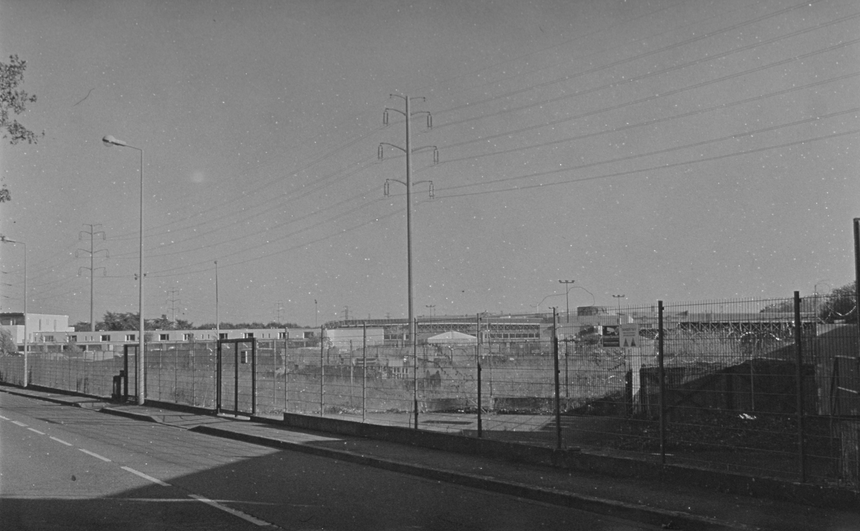

Hello folks,
First things first : i do not have any dichromate on hands and if i could i wouldn't because of the toxicity.
That being said, i'm experiencing trouble with my fomapan R100 processing, see those tiny white dots all around ? That's my problem...

The bleach is that one bath which does not appear in regular B&W processing, and it seems to be the bath most prone to problems. I had brown spots just like that when I tried to use freshly mixed Potassium Permanganate bleach - apparently some small bits of Potassium Permanganate dissolve very very slowly. In your case the week long storage of Potassium Permanganate could have led to formation of Manganese Dioxide or something insoluble, this could be the reason for your bright spots. Since Potassium Permanganate solution is dark colored and barely translucent, it is difficult to determine visually whether there is some precipitate in your bleach solution.
After experiencing these brown spots in my first B&W negatives, I started mixing my bleach an hour or two before processing starts, and filtering the bleach right before use in order to remove remaining bits of undissolved matter, and the resulting B&W slides came out nicely.

Have a close look at the emulsion side of your film. Are the bright spots pinholes in the Emulsion?
If yes: you will find quite a few people reported (on various forums) emulsion peel-off after using this bleach. You can try to pre-harden the emulsion before processing.

For sure i can feel the white dots on my finger, it feels more like a ruggedness than pinhole... like something got caught in and wont leave. But i'll look again and closer. The density of the white dots is not the same through the film (the closer to the center of the reel the greater the density). I did thought about doing a chrome alum bath as a hardener, but after i increased the Sodium Bisulfate bleach's solution from 3,3% to 10% the emulsion wasnt soft anymore and the white dot density decreased even more when i switched to Sodium Hydrosulfite (60gr/film 135x36 concentrated at 13,2%, around 455ml) instead of a regular second developper.
Potassium Permanganate is not overly stable in solution and usually precipitates brown Manganese Dioxide after a while. The Sodium Bisulfate essentially acts as a strong acid, which does not prevent the reduction from MnVII to MnIV, but does prevent formation of MnO2 precipitate. No idea what else could have formed in your Potassium Permanganate stock solution, but something apparently got into your emulsion and blocked the second developer. Since Sodium Hydrosulfite is a very strong silver ion reducer, the effect of this blockage was apparently reduced but not completely avoided.

Just to be sure, we are talking about a positive film slide, right? So when you scan the pic you show us, you do not invert it, but it is a straight scan of the transparent film? When you speak about “greater density” of white spots, you mean there are more and they are bigger, or are you referring to a logD?
Particles on the emulsion usually appear as dark spots on a straight scan, no matter what colour they are. So if you can feel something with the finger, probably the emulsion has been damaged.
If chrome alum does not harden the emulsion sufficiently, you can also try the Moersch Hardener which is commercially available. Furthermore, you can try to reduce process time and or lower the process temperature in order to minimize the softening of the emulsion. You have that film in process for almost one hour. A well hardened film should be able to withstand that, but with poorly hardened film, it can cause problems.

Are you sure it is from the permanganate bleach because I got excatly the same using dichromate bleach. This has happened with two films of the latest batch. With too many ongoing projects I just didn't have the time or inclination to investigate it. Batches of this film 2 or 3 years ago experienced a different marking issue and I assumed that this is an emulsion fault. The marks I get are not consistent on all frames.
@richyrd : no idea, never processed it in dichromate bleach, i'm doing test processing as a side project for little less than a year now and i've always experienced that issue. Because there is always more dot on the film at the center of the reel, and because there is less dot since i've switched to Sodium Hydrosulfite, i'm leaning to think taht thoses dots are Manganese Dioxide, so mixing a bit earlier and filtering will probably do it (i hope). Also, i think i should probably overdevelop a bit, to allow the bleach to work a bit more on that anti-halo layer (but i might be wrong).
@RauschenOderKorn : i've checked my latest test that also got white dot but a lot fewer, the film it smooth as hell, so two next step are filtering bleach and hardening the emulsion.
