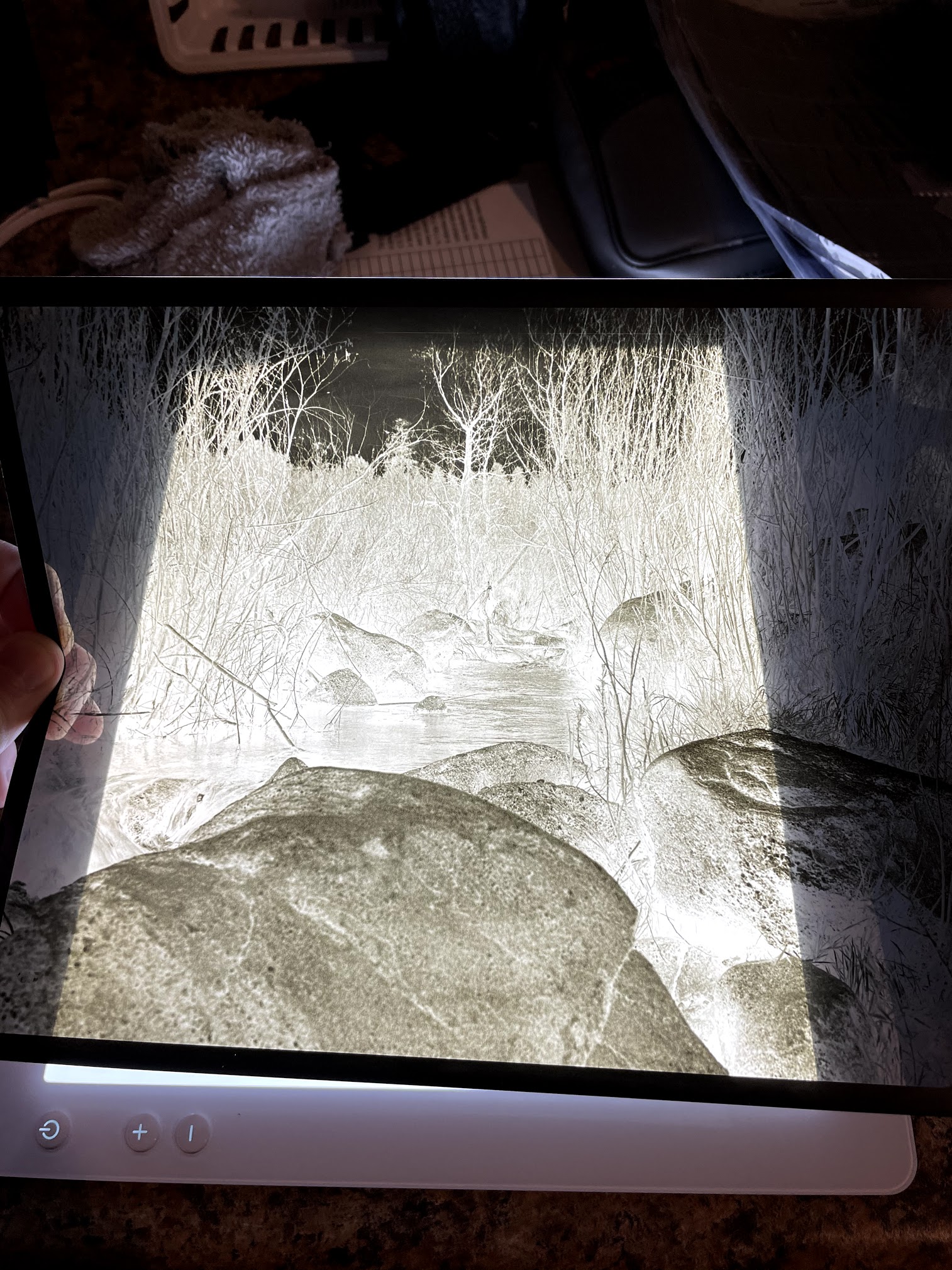

The results came out great with ortho litho film, though I think the 2nd developer could be better. I might revert back to Liquidol or another paper developer with sodium sulfate added to reduce swelling. Although with the iron out developer the emulsion wasn't overly fragile, there is very real "texture" to the final dried film, holding it at an angle the black lines of the image etc are visibly lifted from the film base.
Example attached
