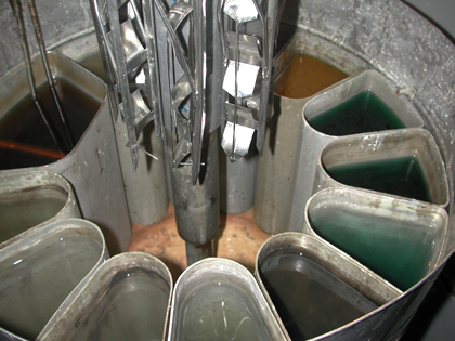

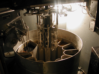

Here's a few pictures of the inside of a typical vintage photobooth. There are courtesy of photoboof.com. Nevertheless, you can see the tanks, the spider which cycles the paper through each chemical bath, + the camera and roll-paper magazine.
