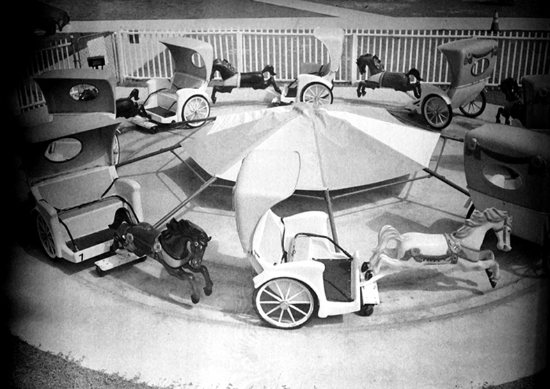

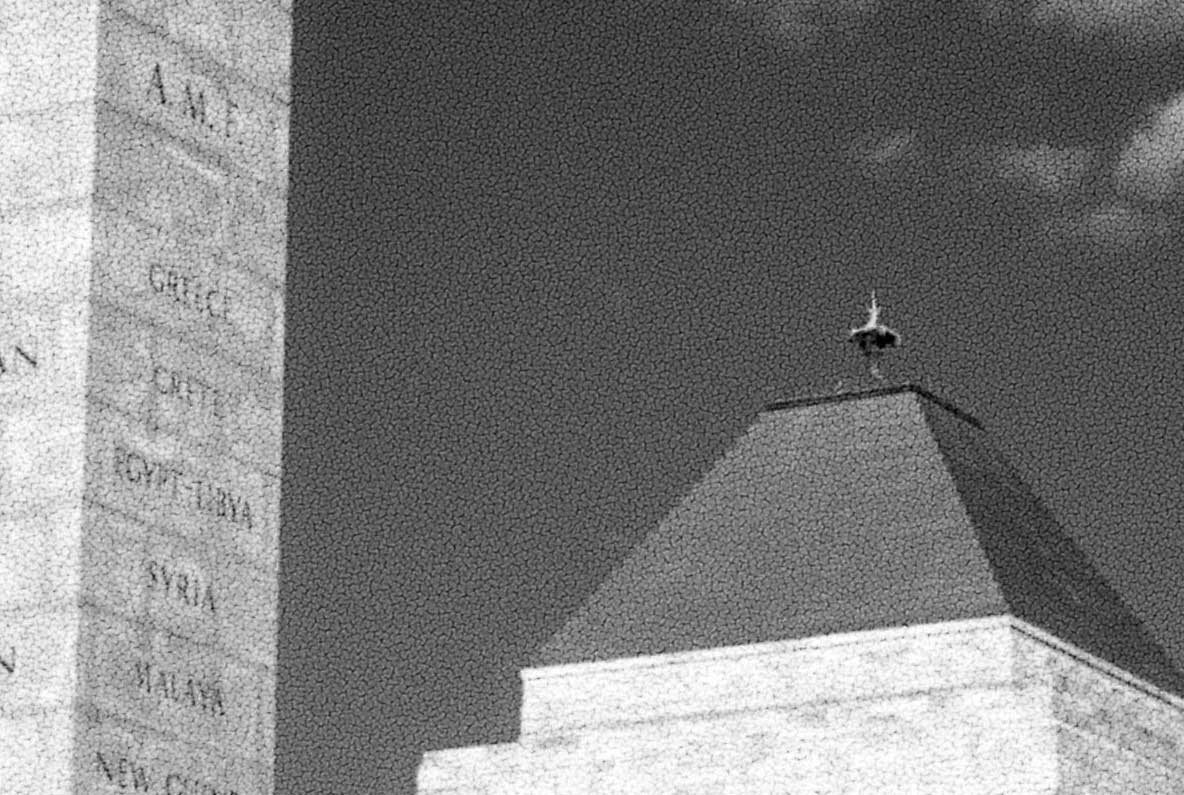

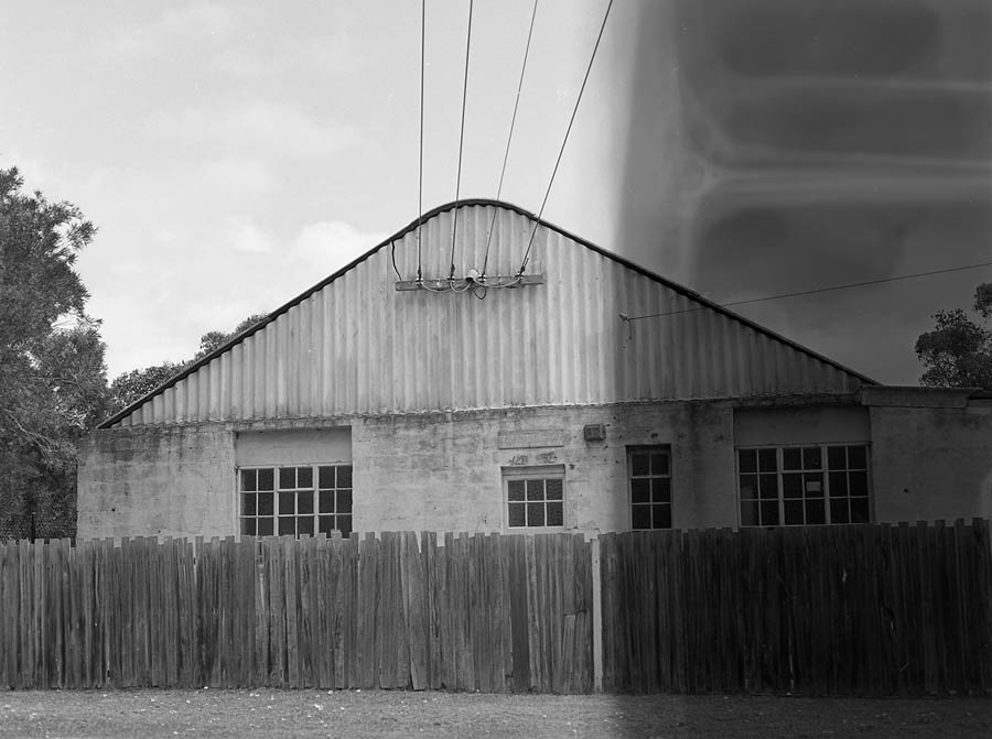

When I first started developing I used that little stick to twirl the film instead of doing inversions. After the first example, I threw it as far as I could. The second shot is what happens when you use a hood w/o first testing it w/ a ground glass. The third is what happens when something actually works right (from an ancient Agfa Isola w/ a single element lens). All too often I have trouble centering the shot on cameras that have simple viewfinders, but for once it worked.
