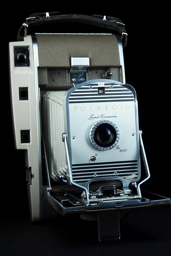

The old polaroid land film cameras eg. "the land 800" will shoot almost 4x5 (3.5x4.5 ish) by just putting film in them. But they are a one shot deal like that, and must be loaded and unloaded in a dark room. Can be had very cheap because the polaroid film is no longer available, usually shipping costs about the same as the camera.

Any Polaroid that took Type 40 film, see the Land List http://www.landlist.ch/landlist/landdcam-roll.htm. 4X5 fits perfectly, you do waste some of the film but you get the nice rounded corners. Best to get a rangefinder model like the 800 that Digger mentioned, that’s mine below. You can scale focus with the non-rangefinder models. This is probably the cheapest way to get into 4X4 other than making a pinhole camera.

Polaroid Land Camera - The 800 by Bryan Chernick, on Flickr
