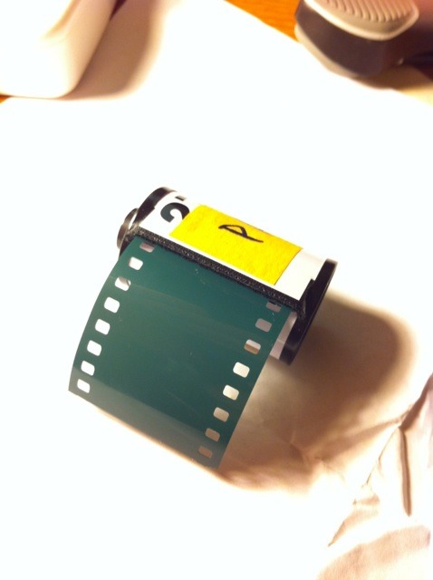

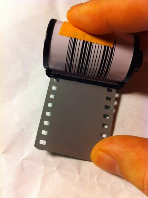

Here is an image of some panatomic x that I have ready to be developed. This is from a bulk roll. It's a dark blueish green with a grey emulsion side.
ImageUploadedByTapatalk1367024054.566829.jpgImageUploadedByTapatalk1367024066.428426.jpg
Develop a clip test and you should see an emulsion no. or other i.d. on the edge markings. Especially so if it is Kodak product.
The question is fair enough but I would have thought that the first reply from Frobozz and a later one from mts provide the definitive answer without needing wild stabs in the dark. OzJohn
