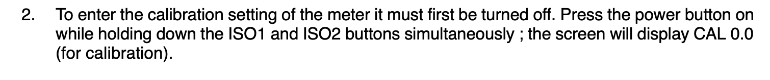

I found this statement on one of the ILT webpages:
"(Note: Non-ILT meter calibration does not include internal manipulation of the meter's stored calibration. A scaling factor (multiplier) is provided for non-ILT meter calibrations, along with a certificate of calibration. For devices that allow programming, a new calibration factor, ILT supplies the data required for the end user to adjust the readings/internally stored calibration factors.)"
