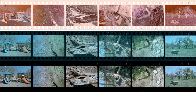

As far as cutting and packing film, I would cut the 4x5 sheets with a rototrim that has a stop built in, specifically made for cutting rolls to sheets. I would get a slitter for 61.5mm film made, and cut the roll to 65 inches long, and then maje either 2 220 rolls, or 4 120 rolls with the 5 x 65 inch strip. Rollfilm would be rolled in paper by hand, and would have stickies at both ends. It would also be wrapped in red paper to prevent light leaks, similar to in function to the foil wrapper that Ilford, Kodak, and Fuji use. 4x5 would be put in a plastic bag, and then in an envelope, similar to old style Ilford paper. I wish I had machinery to do this, but I don’t, it would all be done by hand. Here is a picture of rollfilm I have made before:
