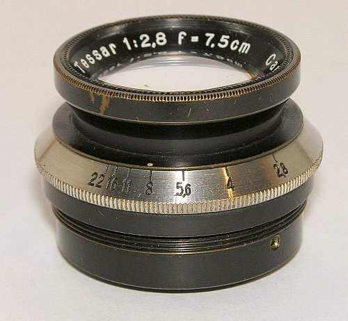

Hi Friends,
I have a Tessar 7.5cm f/2.8 barrel lens without a shutter.
To use it handheld, I need a short shutter speed. Would this be a way to achieve that—a mini guillotine shutter?
Attaching a spring from a ballpoint pen to the two pins. The slit width determines the shutter speed.

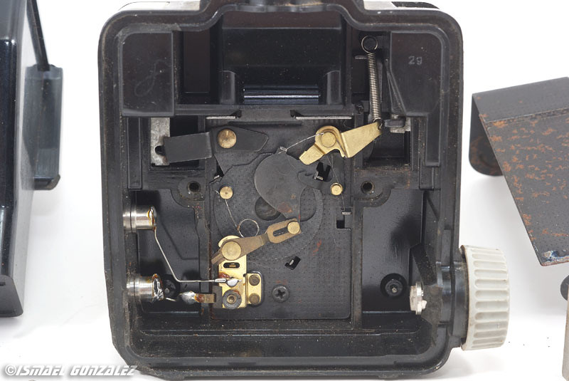

good idea, like this?
I've been toying with the idea of building a shutter from the swinging arm of a dead disk drive. Those things move fast; maybe less so when loaded with a piece of dark slide, but still... Never went any further than daydreaming.
Which camera do you want to use the lens on? How fast is "fast"?
That reminds me of larger version of the Kodak Hawkeye shutter.

In that case, mount your lens in front of a cock-and-shoot Compur or Copal #1 shutter. Front mounting requires a threaded bushing, perhaps cup shaped. Front (female) end threaded to accept the rear of your 75/2.8 Tessar, rear (male) threaded M40x0.75 to screw into the front of the shutter. I'd like to suggest a Polaroid MP-4 Copal #1 Press shutter, but in my experience these inexpensive gems' top shutter speed of 1/125 is usually slower than you'd like. Same goes for Prontor Press #1. Still worth considering, but ...

I must not have been clear. The lens goes in the adapter, the adapter goes in the shutter. If the lens is threaded M40x0.75 at the rear it will screw directly into the shutter, just don't screw it in too far.
Your old Compurs may not match the post-WW II Compur/Copal standard, check before ordering an adapter.
I asked which camera you intend to use the lens on. This matters. According to https://www.pacificrimcamera.com/rl/00498/00498.pdf, it won't quite cover 6x6.

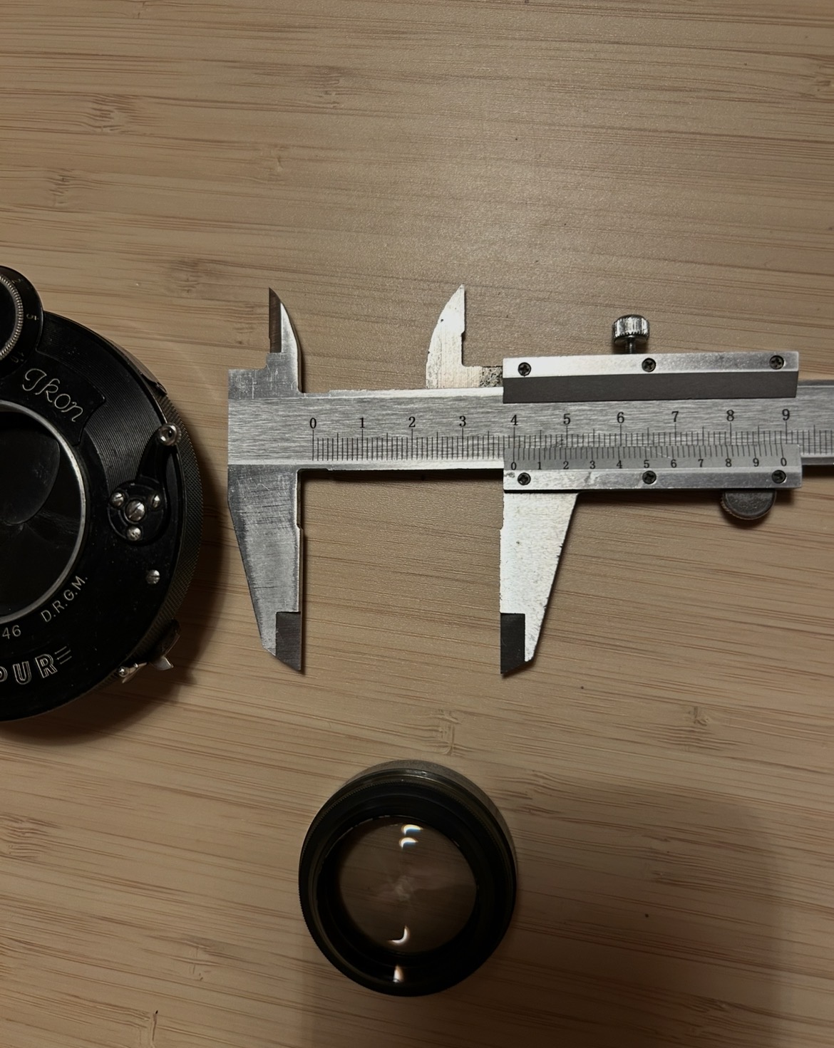

It is for use on a 6x7 camera. I measured the shutter, it’s M40 but I can’t measure the exact pitch. The Tessar already has an M39.8/0.75 screw mount, but as you can see in the photo, it might really go in too deep. If I understand you correctly, the complete barrel lens is screwed in from the front, and no lens is mounted at the back. My English is not good, so I use translation programs.
Thanks for the photo. I see the problem. If it is real, a cup-shaped adapter will solve it, but coverage will be a problem. Whether the lack of coverage will bother you depends on your preferences. De gustibus non est disputandum.

This Tessar lens should fit to a size 00 Compur shutter.
This are available for little money. The fastest speed of the shutter is 1/500 sec.
Unscrew the lens elements and the thread diameter should be 22.5mm
Maybe it has the larger barrel than it fits to the Compur 0 shutter and the thread diameter is 29.5mm
Nope, see the dimension given in post #12 above.
You are right, normally a Tessar with this data will fit into a Compur 00 shutter but this lens were made for the Exakta 6x4.5cm. A prewar medium format camera, used 127 films.
So it is possible that it has different threads.
But you can try to buy a Welta Weltur with a 75mm Tessar f/2.8
The lens in the camera are mounted into a shutter, ready to go and often find for small money.
