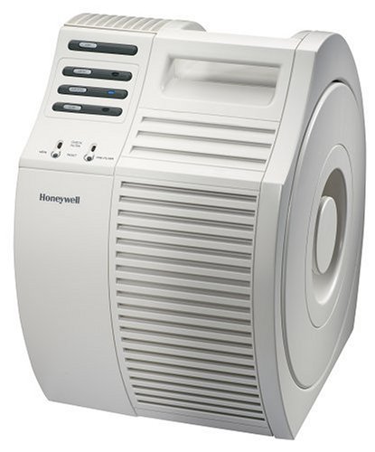

Some thoughts based on the pictures.
1) Looks like particulate material on the surface of the film
2) You have not ruined your film with stop bath
3) Mix the wetting agent just before use with clean water and discard it after use.
4) Can you see dust floating around in your drying area (sunlight though a window or a flashlight can show it)? Consider one of these:

ic-racer: The dust particle was very low. Even those were after 5-6 hours later when the bathroom was all dry. Essentially it is the most dust free place in whole house. That gadget might be useful, but I'm not planning another electric gear now (as I'm trying to save for a MF camera).
