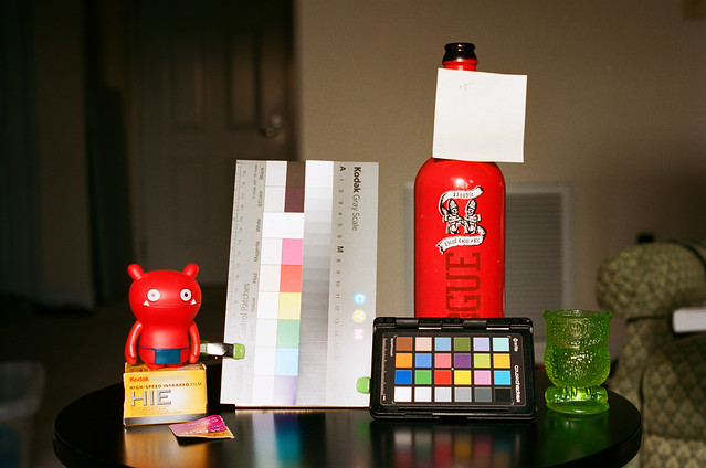

Sorry it hasn't lost detail at all, I think you need to recalibrate your monitor, and if you're not on a calibrated monitor but a typical low quality LCD (especially the ones Apple ships) then such a judegement can't be made by a visual inspection. And your exposure must have off +5 or more stops to begin with before overexposing those 2 stops. Or you simply do not understand image reproduction from a negative. I overexpoed Portra 400 in the sun +5 stops, the brightest highlights have detail in them.
IE: The following is +5 stops, there isn't anything on there in the real scene that had contrast that doesnt have contrast on the negative (no contrast = no detail/blow out/burned out etc), comes a point where you got to decide what shall be black and what shall be white on your neg though. The detail isn't lost at +5 in direct hard Aussie sun, it certainly isn't lost at +2. That is a problem with your workflow and not the materials (New Portra 400).
Exactly.
True for old Portra too. :smile:
