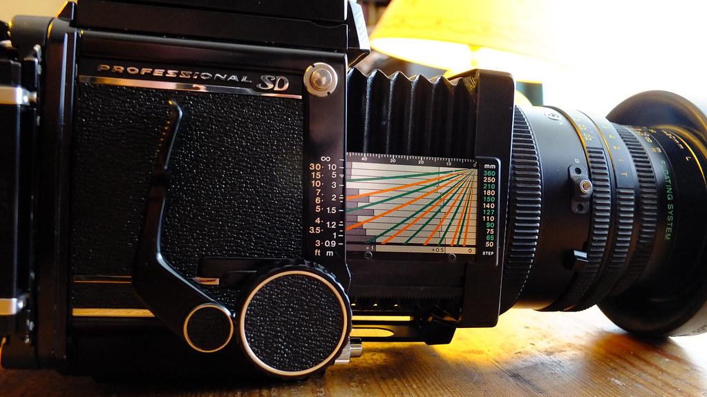

If my memory doesn't fail, a close-up portrait was just barely feasible at full bellows extension. This picture of the RB focusing scale shows that this condition happens just across the +0.5 and +1 correction. Wether this is or isn't an annoyance may depend on the photographer, of course. For me, all considered, everything conjured against the 250mm as a convenient lens for portraiture.
I agree that it's a good lens and that it's pretty fast for its focal length, however in my opinion there are other lenses of the Mamiya RB system that are more portrait-oriented. Of course a portrait can be taken with a 250mm, but I wouldn't suggest it as a portrait lens for this system.
