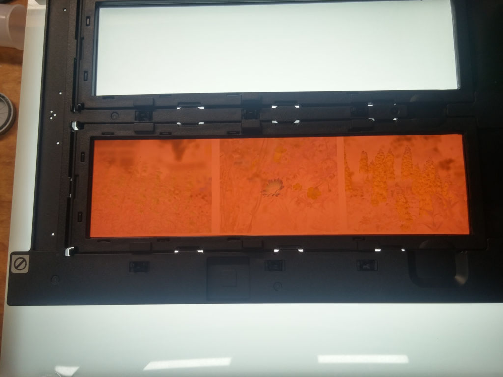

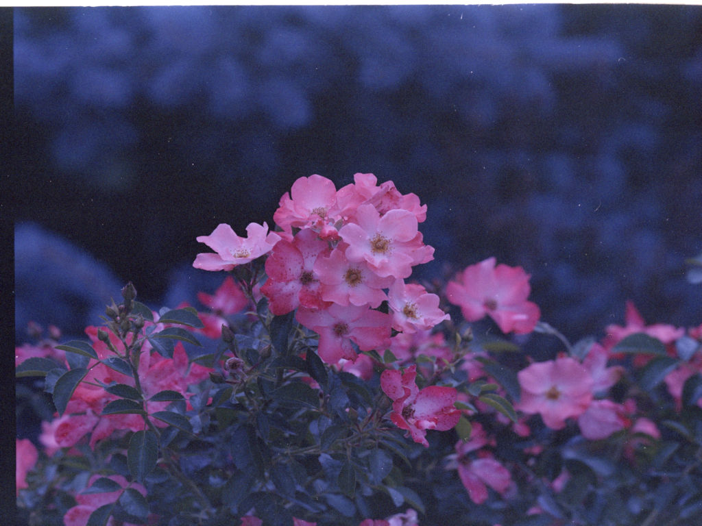

I took my RZ67 out and did some shooting. I got a fresh batch of C-41 chemistry and mixed some up. I should have suspected something when mixing the blix and it fizzed. Not thinking about it, I processed a roll. Of course it was a fail, totally clear film ( right color base ) with no edge markings. Dumped it and mixed a fresh batch. I grabbed some old ( 2002 ) Portra 400VC that I had. Always been refrigerated. I processed that roll, and while there were images the film looked fogged. It was even across the whole roll. Colors are off and very grainy. I then decided to try a roll of 35mm. Had a roll of Portra 160NC. It processed just fine using the same chemicals . So I tried another roll of the Portra 400VC 120 film. This time I tried a different back just in case. Got the exact same result, muddy grainy, fogged look. Has anyone had Portra go bad? I know it's old but was always well stored. I really don't think it's anything with the RZ or Backs, last week I shot a roll of Velvia and it was fine. ( I've been getting to know the new AE prism I put on it ).
The picture of the negative actually looks much darker visually.

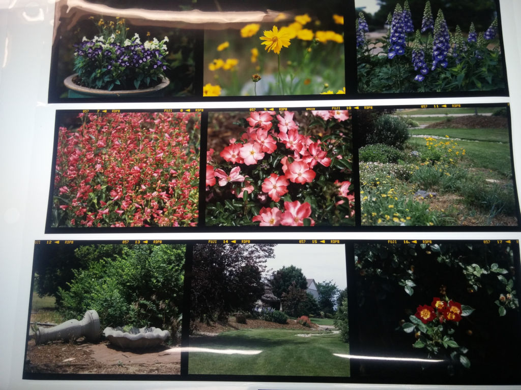

Last pic is the Velvia just to show that I don't think there is a camera issue.
Any thoughts? Bad Portra?

Blank film with no edge markings suggests fixer was the first chemical used in processing.
The photo of negatives in the scanner holder look generally OK, a little thin maybe.
The second image looks underexposed.
Agree that poorly stored and expired C-41 film can deliver less than good results.

The film I'm using was properly stored. The image scan is from the roll in the film holder and is how the whole roll is.. For some reason the picture makes the negative look much better than it really is. They are just muddy and flat.

The negatives look under-exposed to me.

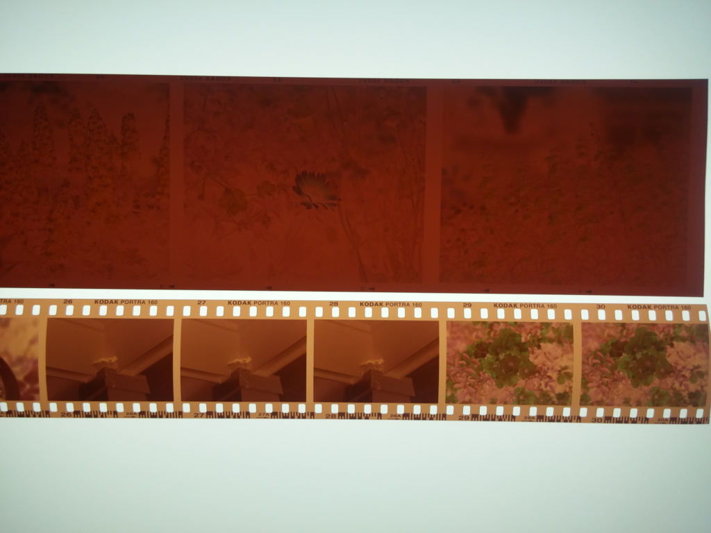

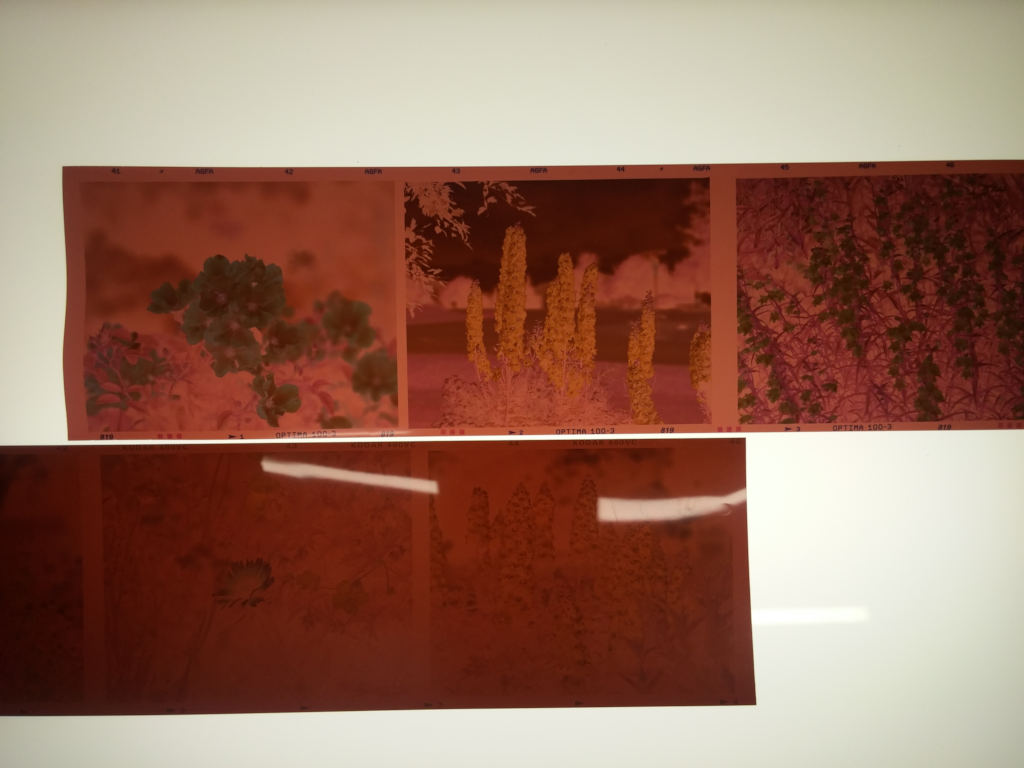

That was my initial thought, but the between frame areas and boarders look fogged, exposed,..... The shot in the frame holder makes them look much better than they are. Here is a new shot showing the RZ negative and a 35mm roll I took just to process in the same batch of chemical.

Do you have any examples of C-41 film properly exposed and developed with the RZ? Do you think there could be a camera related issue? You mentioned you just put an AE prism on the camera. Have you compared the AE prism reading to a known good light meter reading? All variables are still in play until you rule some out.

Based on the Velvia sure looks like you know how to determine exposures! The fizzing sounds very odd, never seen that with C-41. I have used plenty of old black and white, I've not shot color that old. I have refrigerated sheets of TMY-1, went expired in 2001, still looks great

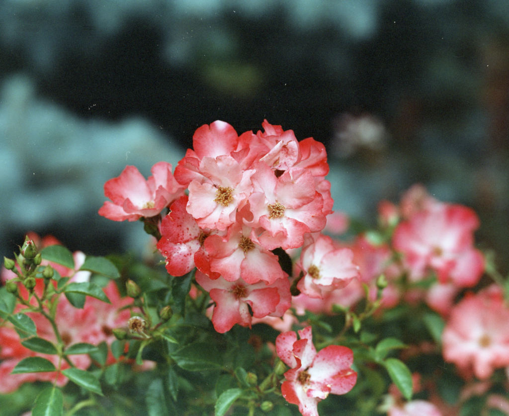

Now that the negatives are dry, I can show the different.
First pic, good negative Optima vs muddy Portra. Second pic, same flowers as in original post. Dust is an on going problem for me.
Anyway, I think I'm happy knowing everything is working correctly.

These were my first attempt with color negative film ( I usually shoot B&W and E-6 ) on the new AE prism. The Velvia was with this new AE finder and other B&W rolls were also fine. So in the end there were two issues, First roll ( was Optima 100 ) got my bad mixing. The rest was the Portra. Not sure why it is bad. Even though old, it was stored well ( refrigerated ). In the end, things are sorted out and I can move on knowing the AE finder and camera are working properly.
