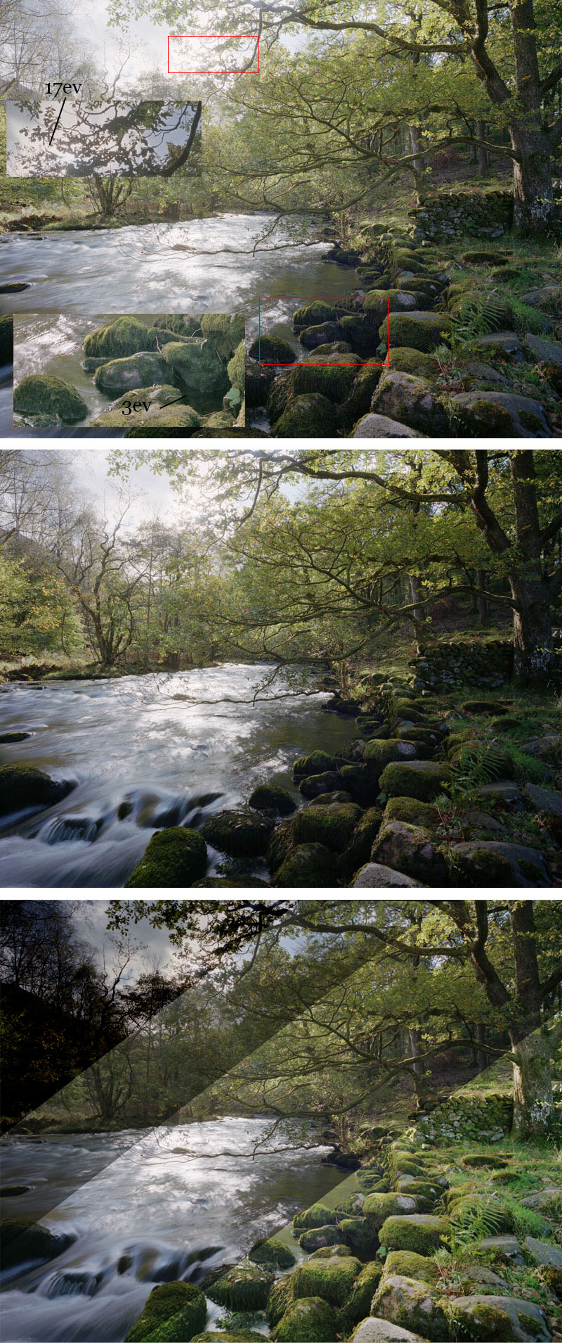

The reading I've done in terms of film exposure is geared toward B&W. Are there any differences in use of the zone system or exposure in general that I should know about for Portra?
Unless you are printing onto paper, you don't need to use filters (maybe the UV is worth it if you are really high).
As for exposure, I've done quite a lot of testing and the dynamic range is immense in the highlights, up to +14 stops
I exposure Portra for the shadows and let the highlights go. Portra 400 place the darkest shadow with detail at -3, Portra 160 I would expose the shadows at -2 stops. The advise to shoot at half box speed isn't a bad one as long as you know why :smile:
Because of this, my Portra 160 landscape exposures very often end up as exactly the same as my Velvia exposures... that tells you a lot about exposure rating..
Portra 400 copes OK at box speed because it has more scope in the shadows..
Here's a portra 400 shot..
http://static.timparkin.co.uk/static/tmp/portra-test-pp.jpg
This was reading from 4EV to 19EV and nothing is blown or blocked
here's another scene with the same dynamic range where I've opened up the shadows and burned the highlights to show what real data is there..
http://static.timparkin.co.uk/static/tmp/dynamic-range.jpg

Could you expand on this as from my own admittedly naive reading, a one stop increase in yellow and a one stop decrease in cyan would mean a huge shift in temperature but only one stop doesn't move significantly up/down the dye sensitivity curve?
Also, as far as I know, Porta is actually a combination of three different sensitivity layers for each colour and hence the film almost works as if it' shifting registers. 3 or 4 stops over exposure and you're into the medium speed register, 8 or 9 stops over exposure and you're into the very slow film register. Does that make sense?
Tim
