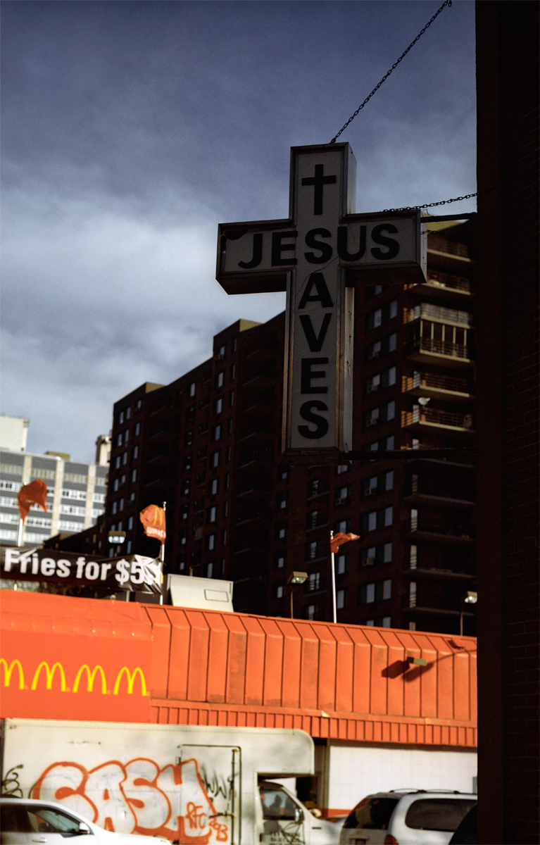

I used Portra 800 mainly for night photography and I had no problem at box speed or pushed 1 stop. I used it once at 1600 on a sunny day (some frames left from the previous night roll) for a street photography style and the contrast I get was really high.
The photo below is an example of that roll. I tried to save highlights in the scanning and I lifted shawdows in the edition, specially in the cross in the foreground.
So you underexposed film by a stop and then had to fight blown highlights?! Does not compute...
The scan just looks like an underexposed shot of a high contrast scene.
Underexposed 1 stop in camera and overdeveloped (30 seconds as Tetenal Colortec instructions said), the definition of "push". It was also an underexposed scan with NikonScan and a Super Coolscan 8000 ED.
