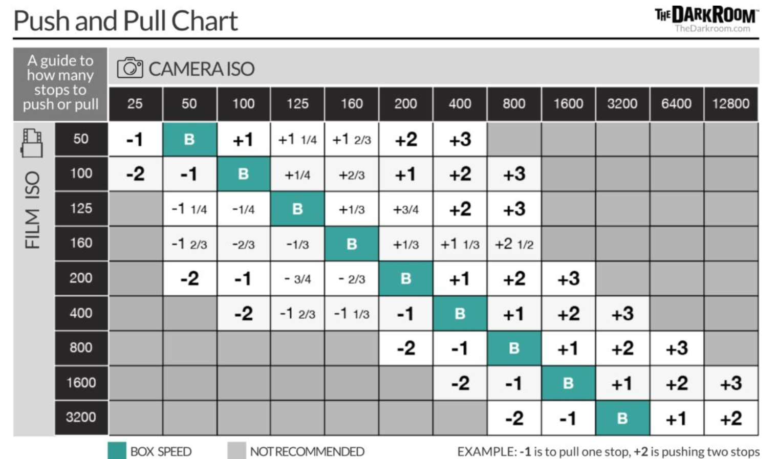

I am shooting this at 1/200 in my Minolta Autocord. I found somewhere that I can push by 1/3 stop during C-41 to account for this. However, is it really necessary? If I don't push will I end up with less contrast? Less saturation? If I do push by 1/3 is there a published/accepted correction amount specifically for 1/3 stop? The FPP website comments only address full stop push correction (i.e., add 1 minute and 40 seconds for one stop and 2 minutes and 25 seconds for 2 stops). This is not linear so I am nervous about interpolating between zero and 1 stop push times. Doing a graph suggests roughly a 30 second increase. Is that a safe approach? Thanks!

Excuse me, I meant ISO200. The 1/200 came from the Sunny 16 rule when I use the 16 aperture. As to shooting at the 160 box speed my Autocord is new to me and does not have "clicks" for shutter speed and aperture. It doesn't have a meter so there is no ISO setting. I think, but I am not sure, that it would let me position the shutter speed between 1/100 and 1/200 (i.e., very close to 160), for example to use Sunny 16 at the 16 aperture setting. These comments suggest that splitting hairs for the deviation from the 160 box speed is not worth it, so I will probably just use C-41 without a pushing adjustment. Thanks!

The stop adjustment is in The Darkroom chart. Just information - they don't comment on whether it needs to be done.
