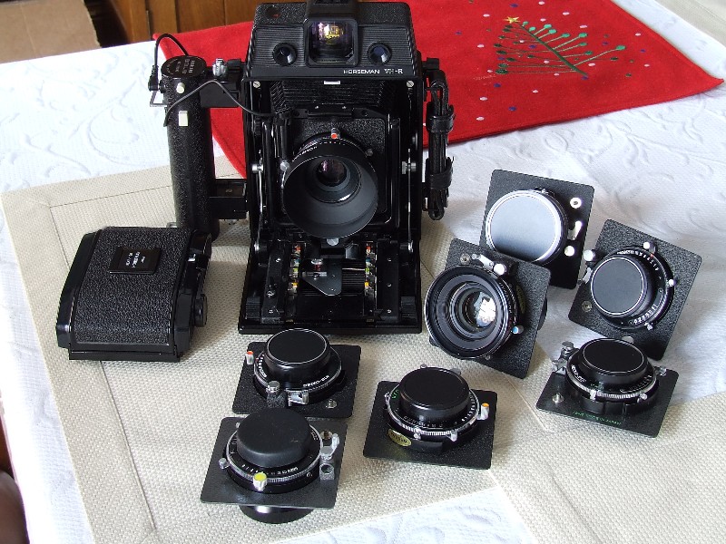

I use a Horseman VH-R, it is pretty nice while traveling because it gives me the option of using it as a view camera or a rangefinder.
