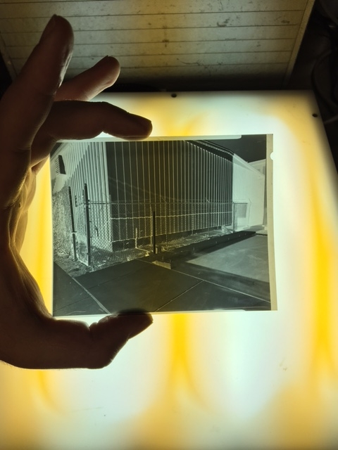

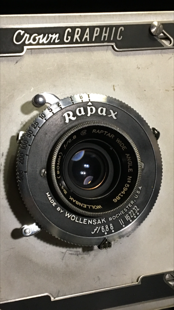

i went ahead and bought a very clean Wollensak Rapax 90mm f/6.8 from a local shop and shot 4 sheets in two double holders around the neighborhood this morning. used the ground glass to focus, then recomposed with the sports finder as Ian had suggested.
I plan to readjust the infinity stops and have a crack at recalibrating the distance scale still.
interested to see how it comes out, will report back. the film is fresh arista (foma) 400.
Graflex standard for infinity is to use a target at least 5000 feet away (farther is better) with the lens wide open. The front standard will twist a little giving swing to one side or the other when the standard lock is set so measure from the end of the rails to the edge of the front standard on both sides ensuring they are the same before locking the infinity stops in place. Speed Graphics from introduction in 1912 through the end of the Anniversary Speed in 1946 set the rails fully retracted into the body for infinity. Speed, Crown (1947-1973), and Super Graphics (1958-1973) had the rails set .040 ± .01 inch forward from fully retracted for infinity allowing one to focus past infinity or find the sharpest point. Your choice.
Focus scales were cut for specific focal lengths. A 90mm lens from any manufacturer may be 88mm to 92mm in actual focal length. A focus scale cut for a 89.5mm lens will be off at 10 feet or less if used with a 90.1mm lens. A focus scale for a 127mm lens used with a 90mm lens will be off between 100 feet and 50 feet and closer. Its easier to measure from the film plane and make a new scale from scratch. A 90mm should focus down to 3 feet.

thanks, shutterfinger. looks as though it might not be as easy as i'd imagined :wondering:
in other news, the lens seems just fine. adequately sharp corner to corner.

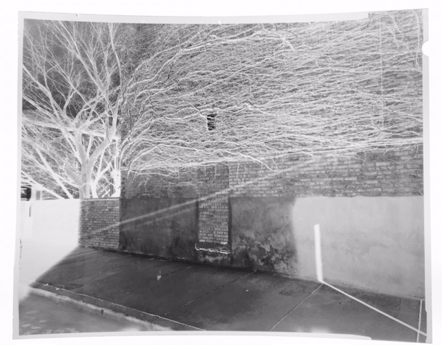

now i just need to find the handle in regards to which processing method is going to work the best for me. did those 4 sheets in a unicolor print daylight tube i have, rolled by hand. two of the sheets had some slight streaking along the short side, which leads me to believe i used too much dev solution. also, the gasket on the lid is pretty messed up and leaks a bit. open to recommendations...

If you set up the focus scale for the 127 at infinity then it will be accurate to about 75 feet, good enough if doing landscape work.
The chemicals should be about 1/3 the diameter of the tube when laying on its side for rotation.
Rotary processing requires an equal number of turns in each direction to prevent streaking. I use JOBO tanks and a manual roller base. I rotate in one direction (finger tip to base of palm) for 1 minute then switch direction (base of palm to finger tip) switching hands to keep a continuous rotation of about 50 rpm. Rotation speed is not that important, smooth and steady reduces/eliminates foaming which can cause air bells.
JOBO 25xx tanks are for 4x5, 2509n reels are for 4x5 sheet film, 2502 are for 120 and 35mm film in a 25xx tank.

streaking can be seen in the attached neg.
thanks for the JOBO recommendations. i have more inclination to attempt tray processing before going the JOBO route, mainly because of the price of admission.
Looks like more development in areas due to the tube sitting stationary for 15 to 30 seconds.
Stationary like inversion processing must cover the film completely.
P.S. could be uneven wetting with developer. a 1 to 3 minute prewash will help prevent uneven wetting.
