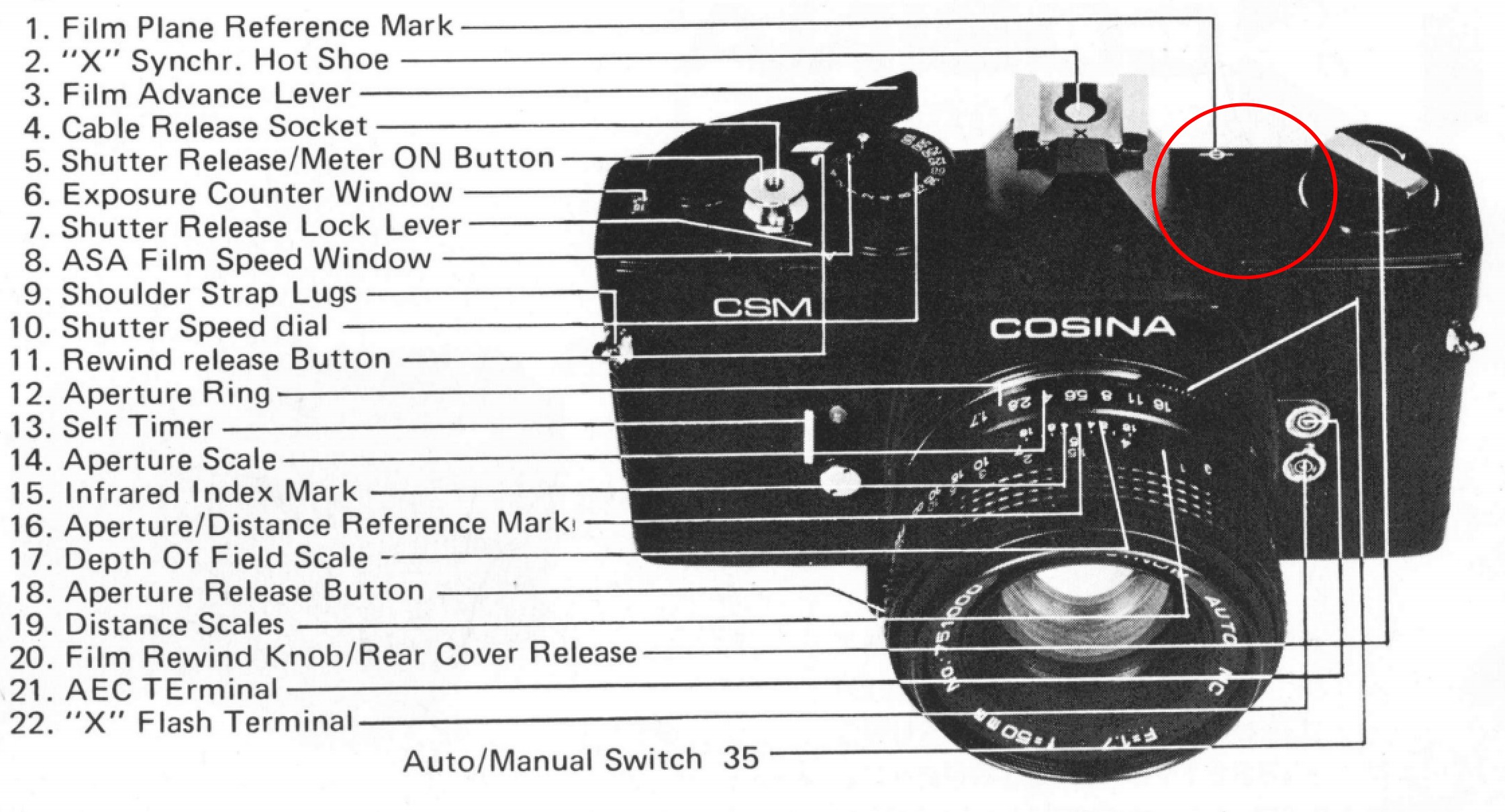

Just got this camera, in pristine condition. I know it's actually a Cosina, and some other details, but not much. Can anyone enlighten me on what exactly these settings do, circled in the photo, please? The yellow circle probably is the double exposure, but what others do, I am not at all knowledgeable.
If anyone has a copy of the manual, I would be grateful !
Regards,
JT

Thanks, Reddesert. Yes, I already checked this, and the meter works as it supposed to. I have the manual, but the camera shown there does not have these two buttons, do see the attached, pls.
Other than that, the Cosina in this manual is pretty identical to the Porst I have.

That's the CSM. Look for the CSR manual. I don't have one, but there is a description of it as a CSM plus spot meter, and the manual shows the extra switches as on your camera. (FWIW, it seems likely the circled features are a multi-exposure switch, spot/average switch, and an M mechanical shutter speed.)
