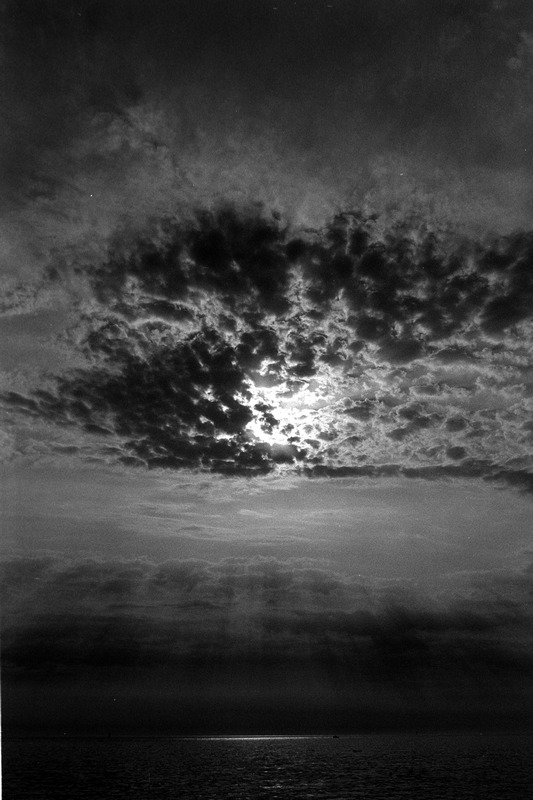

Let me try to explain.
First. before I press the shutter release, I imagine being in my darkroom with the negative; will I feel motivated to spend an hour or so to produce a half-decent print, or is it just going to stay in the negative file? If the latter, I just pass.
Second. From one negative one can make a variety of prints. Expose for these nice cumulus, and let the shadows fall into black, or prefer a more postcard rendering. Ditto from a given scene. When I exposed the picture below --ISO 100, 1/250, f/22, orange filter--, I had already in mind the final picture, not exactly what was before my eyes.
