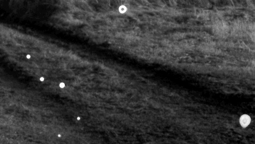

I have this strange issue you can see in the attached file. Fresh or old dev&fix doesn't matter, there is always a dot or two on a roll, or a hundred, as it was recently, spoiling nearly half of frames. Size varies, but it's usually quite big - 0.1mm up to 0.4mm maybe.
It's either a dot or a circle with normal image inside (or just hollow? dunno), quite regular - white on a positive and opaque (almost looking like "unfixed") on a negative. Certainly not a dust or water impurity, it looks completely embedded into the emulsion.
I doubt I can get rid of it. Any clues?
Film: Polypan F, 50 asa, developed in Hydrofen W17 by Foma and Microphen. It's said to be Ilford Pan F emulsion on a clear base, without AH layer. 35mm, a kind of copy film, made in Equador.

It's not Ilford Pan F.

Adofix fixer, temperature ranging anywhere from 17 to 23 C, worst case was at high temp dev, low temp fixer, but the spots are really happening randomly all over my 90m roll.

what do you between development and fix?
do you control the temperature of each solution?

yes, I do control temperatures separately for dev and fixer. I rinse the film for a minute before and after dev with ~12C tap water. If it's a stop bath, why such a strange pattern would occur? It looks like a ton of silver, basically opaque.

"Made in Equador" . . . is that some sort of joke? It's usually thought to be a print film or dupe film originally for cine use, made/packaged by a contract-supplier in Germany (Filmotec?). It has absolutely no connection with Harman Technology, other than the sound-alike marketing name.
As to the odd results you have found, unfortunately I have not seen those before. It would be worth examining the emulsion side of the film very closely, using some side lighting, to see if there is any visible damage in the surface of the emulsion. Is there any change if you re-fix a sample frame with strong, fresh fixer? If the rings were of raw silver-halide emulsion then they would be cleared by this of course. Also try this after de-greasing the emulsion surface with naptha or similar, in case of a grease or oil contamination/protection of the emulsion surface at some point in it's history.

Surface from emulsion side looks normal: semi-gloss, even, the spots look like silver, just really black from this side.
Base side has obviously no change, being glossy, but the spots look opaue-gray, brighter, than the silver. From what I can tell by just looking, it may be either a huge deposit of silver (like when seriously overexposing and overdeveloping) or an unfixed but properly developed emulsion. Darkening can happen naturally, but I doubt if exposing any emulsion to light would darken it that much. There's no visible relief, no change in surface appearance. I've tried scratching it, there's no chance it's a flake or dust stuck to the film, or any other foreign matter. Whatever it is, it sits within the emulsion itself.

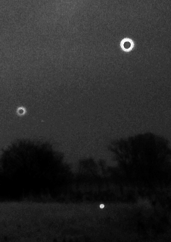

Samples - sure, got plenty. One more attached.
I've been using different cameras, the amount of problematic frames varies from a couple frames to a majority of frames.
Xmas, I want to presoak due to two reasons: first is avoiding bubbles of air I won't be able to shake off, cause I rotate the film, rather than shaking it, second is keeping my dev cleaner - I guess Polypan won't release much stuff though.

Presoak or temperature shock or pH change is causing problems or the combination you are bubbling the emulsion probably before or during development
I never presoak it makes the emulsion softer and there is a pH jolt when the dev goes in note you are more likely to get an air bubble in the presoak cause of pH and that would cause your problem for sure
I never agitate shake or bang tank ~ I do invert for washing
I never use acid stop with film
I don't use an acid fixer just plain hypo
I hold all temperatures to within 1C even the wash
The emulsion is not pre hardened you need to be much more careful than with normal film the soft emulsion on pet base is very difficult the datasheets normally warn.
Your other option is to use a hardened fix but that wont help if the damage occurs earlier as seems likely
Filter your developer through a coffee filter paper if you are worried note I use stock x20 times and don't filter I take the risk of a film chip & sometimes I get one but very rare one every 500 cassettes or so
Your last option is posting the film to me and using cine film instead # Orwo or Kodak still make mono ring all the production people they will have recans and short ends when they have finished filming rare now days.

Maybe damage from gas bubbles caused by a too-acidic stop bath.
Or a manufacturing defect.
Or undissolved chemistry in the developer.
Pre-soak should have no influence on this.
Clip a length of film from the bulk roll and process it, using a water stop and well-mixed filtered developer (after sitting overnight!), without it going through the camera and see if there are spots. If so, it is likely a manufacturing defect.

I can see some spots between the frames, between sprocket holes or on film margins, but that's a very minor minority, Doremus.
