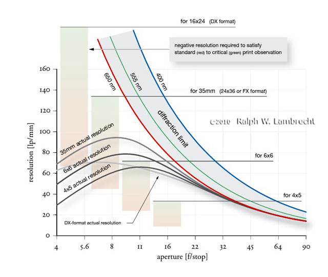

All my results packed into one chart attached:

i would love to know the resolution of the lenses and methods i employ
but i have never been educated in the black art of resolution tests,
so i just shrug my shoulders.
it is interesting ralph that your 35mm system seems to blow the doors off of your other camera-systems ..
( or maybe i am reading your graph wrong ? )

Since resolution of the camera system is dependent on target contrast, it is impossible to know what resolution I get in the field. Test are a controlled environment which allows you to evaluate a system, but the number is a relative one. You need to understand what will happen under different conditions.
outwest
Aug 18, 2005
565
John, while the graph shows that 35mm lenses are capable of higher resolution than larger formats, it also seems to show that the resolution obtained barely gets the 35 into the critical image category while the 6x6 lens resolution exceeds the 6x6 critical range and the 4x5 way exceeds it. Is that what it shows, Ralph?
so i just shrug my shoulders. ...
Let's not forget, you are the master of beautiful 'unsharp' work!
... it is interesting ralph that your 35mm system seems to blow the doors off of your other camera-systems ..
( or maybe i am reading your graph wrong ? ) ...
You are reading it right, but that's very common. Lens resolution decreases with increasing film format. There is decreasing need for lens resolution if the negative is not magnified by much. Our eyes have a resolution limit.
RalphLambrecht
Sep 19, 2003
14,658
K,Germany
Precisely!

Bill Burk
Feb 9, 2010
9,318
Ralph,
It's a very information-packed chart. Great use of graphics.
I also read off it that 4x5 exceeds critical even up to f/32. Also suggests by continuation that f/64 might be for our 8x10 friends.
Maybe reformulating the statement as follows makes it a bit more clear how to interpret Ralph's graph:
While 35mm lenses are capable of higher resolution than lenses for larger formats, the necessity of greater enlargement of the negative during printing on photo paper, means the actual perceived sharpness and resolution in the print is less than in prints made from larger format films, as those latter film formats (MF and LF) require (far) less enlargement during the printing stage if printing to the same final print size.
But maybe this is a bad interpretation...

This is nearing a digital type thread!!!! Lets talk specs not results.
Why? :confused:
Talk of lens resolution and printing on photo paper is as old as analog photography is, that is, over 150 years... I don't see anything d******l in that. Lens resolution is still sometimes tested with what is called USAF 1951 resolution charts, the design of which is 60 years old by now...
outwest
Aug 18, 2005
565
Yes, Marco, that is exactly the way I took it to mean - viewing a comparable print which requires a lower enlargement factor from the larger film.
