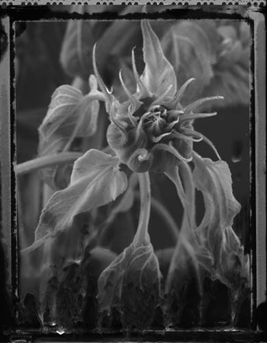

I tend to leave them in the solution for much longer than recommended, up to 3 hours which allows me to easily peel everything off the negative as the glue has broken down by then, the only provisio being make sure you keep the solution on the cool side. I have on several occasions not paid attention to the ambient temp and had the following and worse happen
hopefully you should see an image here, I'm new to all this forum posting stuff so bear with me
anyway, have a play and if you have any specific queries, post them here or email me directly
